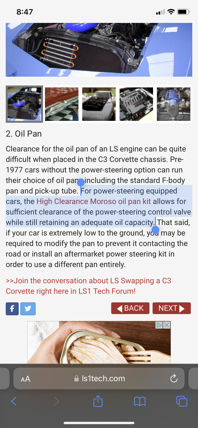

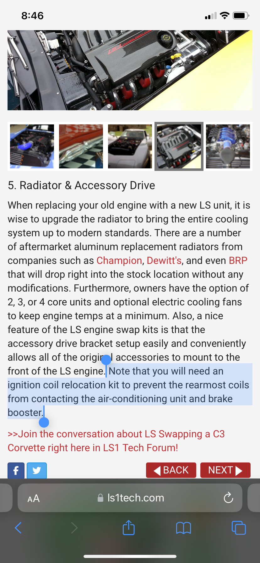

I saw a couple of concerning items on an article I was reading this morning, that I had never seen discussed on this forum before. Could anyone help with these?
This seems to imply that if I have factory power steering I can’t use the F-body oil pan, is that correct?
I have never heard of this concern before regarding the ignition coils. Have others experienced this?
If it helps, I’ll be using motor mounts that place the block in line with the standard bellhousing position, so that I can mate the motor directly to my 4-speed transmission. I believe that makes it 1 inch back.

Easy! Don't use stock C3 power steering.
Of my three C3 chassis, zero have a stock power steering control valve. I also used a MAST pan for more clearance. Not sure yet if that's needed.
what did you do instead of stock power steering?
Stock manual steering (80), Borgeson (79), and R&P (SRIII).
Never going back to the 4-hose kludge GM came up with.
Agree. The stock PS setup is hot garbage and is almost guaranteed to have leaks.
Borgeson here too.
