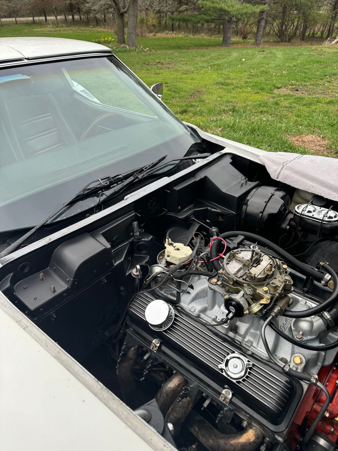

I sprayed everything except the engine with Dupli-Color engine enamel. Chevy orange, low gloss black, silver. I had the air cleaner base & fan powder coated...

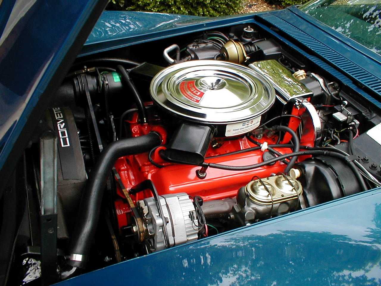

Thanks for the nice comments, Kidster71. Wish you luck with the work on your engine bay. Here is a pic of the bay on my '71 [which has been sold to another 'lucky' Vette fanatic].

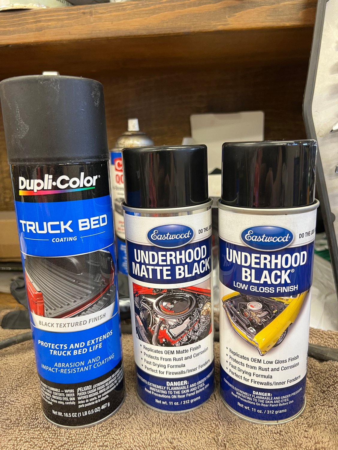

I used Dupli-color truck bed coating on in the wiper bay on my '80, Eastwood Underhood Matte black on the firewall. Eastwood Underhood Low Gloss on most everything else, including underside of hood sprayed with an HVLP air gun. Happy with results. Now the car is at the painter this winter getting the body painted back to original red. Woohoo!
