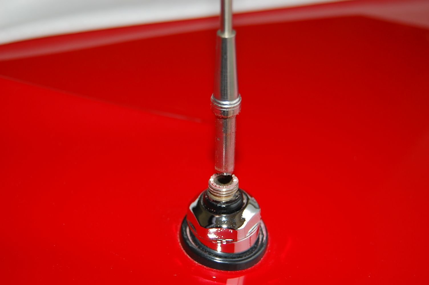

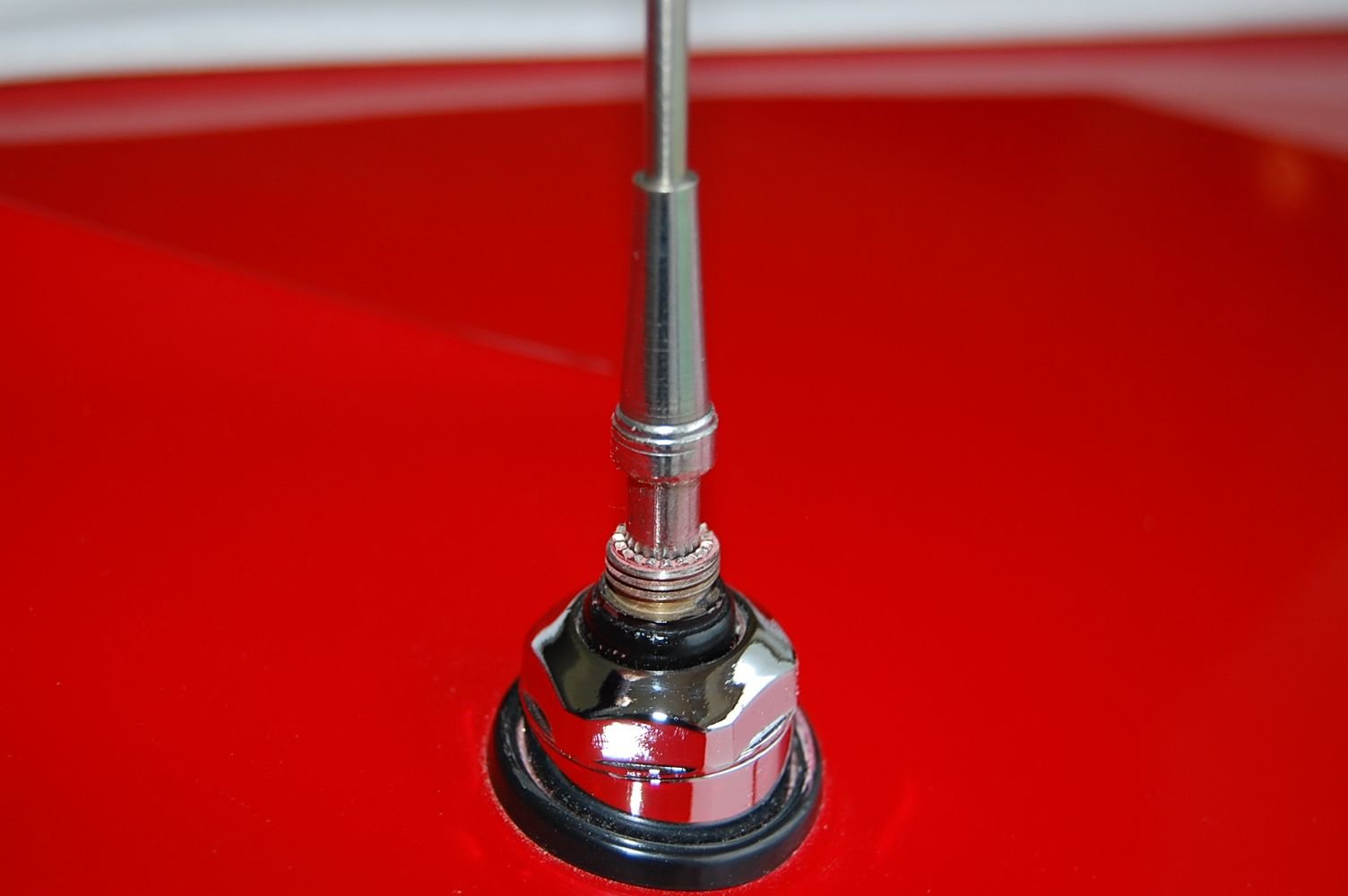

Hello,
Like this for the
Standard antenna.
Regards...

PERFECT! So thats whats on the car, mins that last pic with the small cover. BUT its on there TIGHT, so tight i thought one peace... will try. Harder,.

Mine is like the last picture from Alan too, as people say, just finger tight so I can take the car cover on and off.

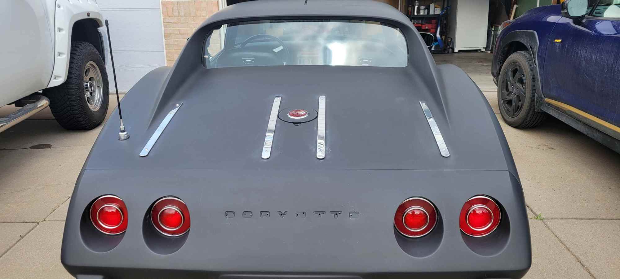

If you not worried about originality you can do as I have done and cut the mast to be all most level with the roof line then slide a small vacuum line over the antenna and capped it with vacuum cap. Looks like black rubber mast and since I use blue tooth not worried about radio reception even though it seems to be ok. If for what ever reason I want to change it back I will need a new mast.
No worries about going on a lift or scratching the paint trying to get the smaller nut off to remove antenna.
Last edited by Mr E's C3; Nov 26, 2025 at 03:10 PM. Reason: Add photos/update status
