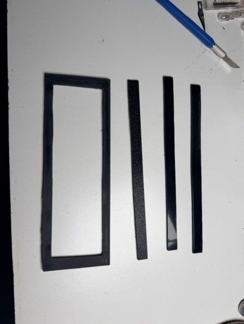

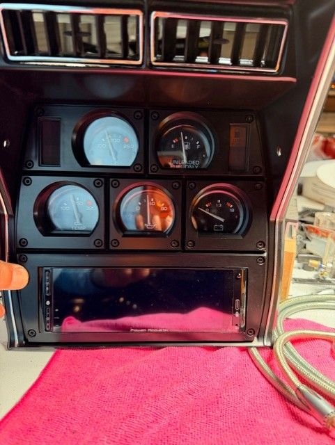

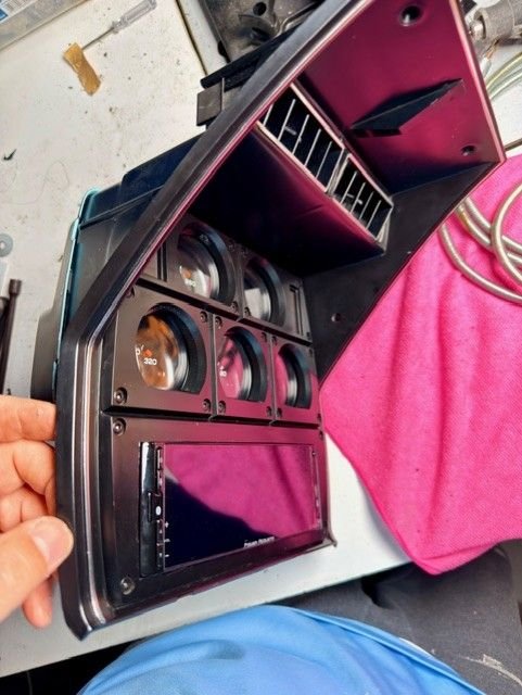

So I decided to build a recessed area so the head unit would be flush with the dash. Bought a sheet of ABS plastic and some ABS glue and went to work.

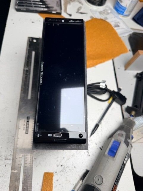

Test fit 1

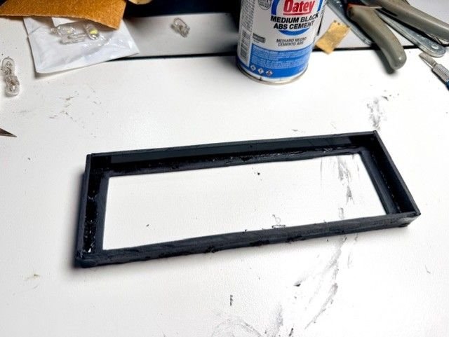

Glue it together and test fit again
I think it's worth stating at this stage I was a nervous wreck. I meticulously cut that opening. MY GOD what a pain to cut it straight and not ruin it with an errant slip-up!

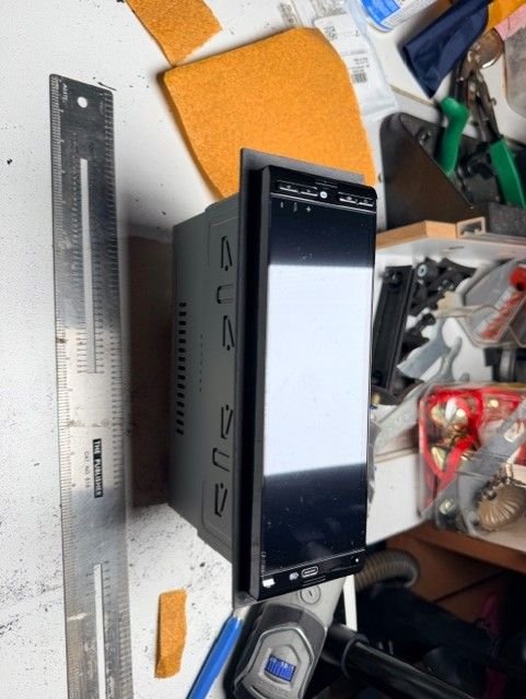

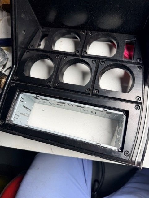

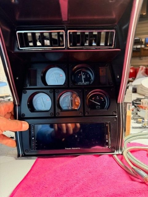

As you can see from initial install, the stereo is pretty close to flush with the front of the dash. I will admit that on the first go around, I actually forgot to account for the thickness of the dash, so I had to cut about an 1/8" from the recessed plastic tray I made before I glued it on.

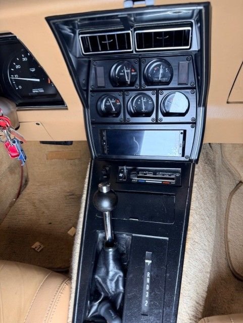

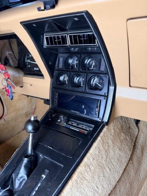

And here is the final install. I think it looks really sharp, doesn't really ruin the aesthetics of the dash and nearly looks like it really belongs there.

That is very, very cool. Perfect for the later C3 console set up.

Looks great, integrates nicely with the stock gauges.
