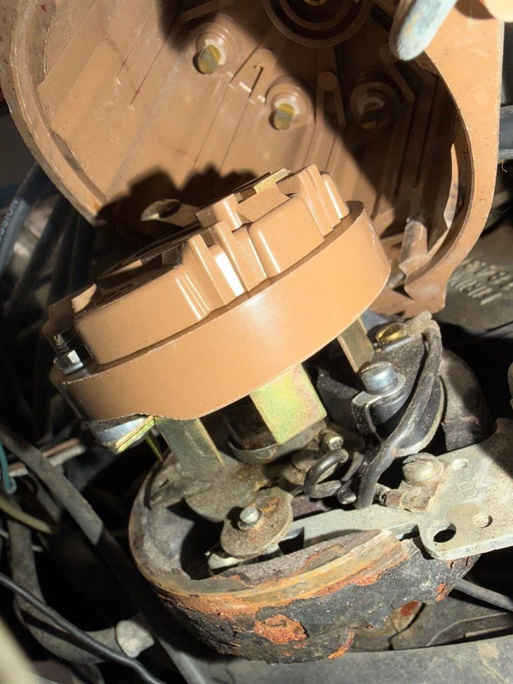

Does anyone know what type of electronic ignition module this is?
Old Jan 5, 2026 | 02:19 PM
  #59
boat196's Avatar
boat196
Joined: Aug 2007
Posts: 894
Likes: 244
From: Green Valley Ca
It looks like SE Breakerless
Old Jan 5, 2026 | 02:57 PM
  #60
zxryder72's Avatar
zxryder72
Joined: Sep 2025
Posts: 470
Likes: 131
From: Colorado
Thanks, that should help to know what's in the dizzy!
Here's a thread with a link in there that supposedly includes troubleshooting steps for it. (I didn't read it.)
Breakerless Ignition - CorvetteForum - Chevrolet Corvette Forum Discussion
