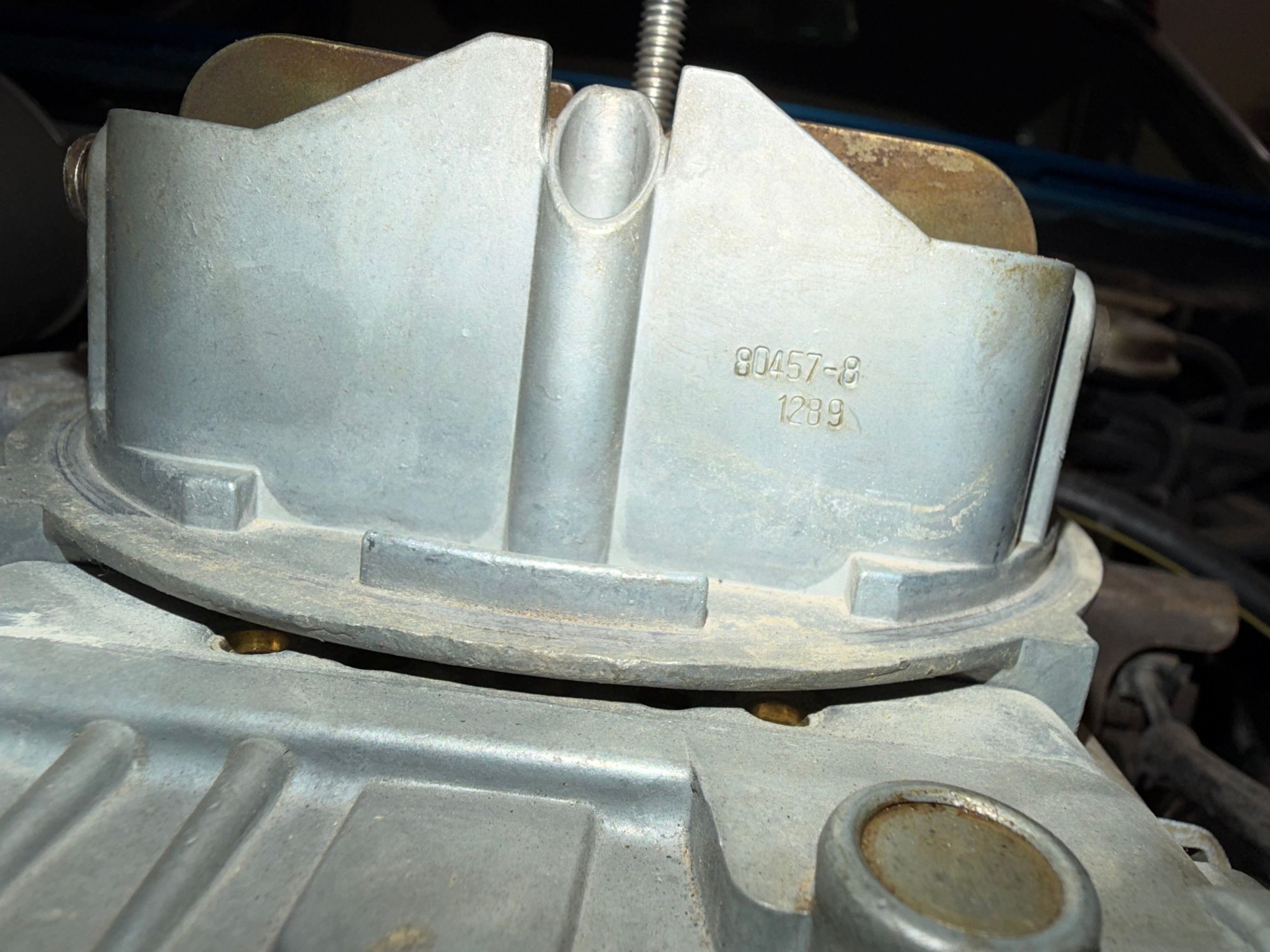

What is the carburetor list number found on the front of the choke airhorn?
80457-8
1289

Originally Posted by mittens
80457-8
1289
Float is adjusted by bending the tang, with bowl upside down float should be parallel to bowl top.
