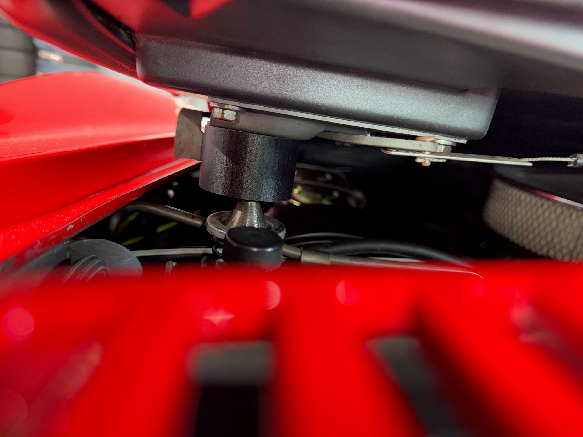

Default Final Solution
Just wanted to follow up on this thread in case someone else has this problem. My problem was a misaligned latch pin (see photo). I had a little trouble finding the alignment tool as it was out of stock in several places I looked. Oddly, I found one on Etsy and took a chance on it. Turned out it worked perfectly so I've included a link https://www.etsy.com/listing/4403163...b%3A4403163982. If nothing else, you can see what it looks like. I loosed the two bolts holding the hood pin bracket and moved it about half an inch until it fit into the hole on the bottom of the alignment too. Now my hood pops up like it's supposed to. Thanks again to all who weighed in on my problem.

I looked those hood alignment tools up and they do look nice.
I ordered a set.
Thanks for sharing!
what's odd is it says that tool doesn't work on 68 and 69E cars... Not sure why but I have a 69E car and it helped a bit.. still gonna have to do some adjusting...
