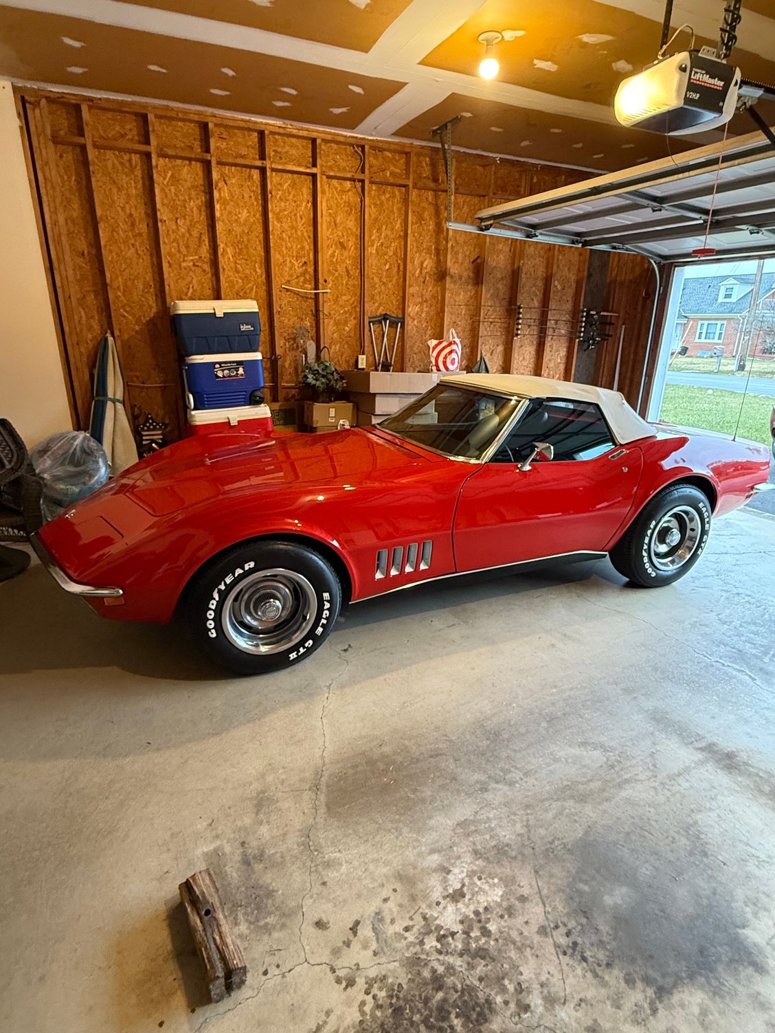

Hey folks, I find myself looking for a passenger side mirror on my 69, is it a horrible thing to put one on. Not concerned about winning trophies. Just used to driving with one. Got it for a Christmas present. Just love it.

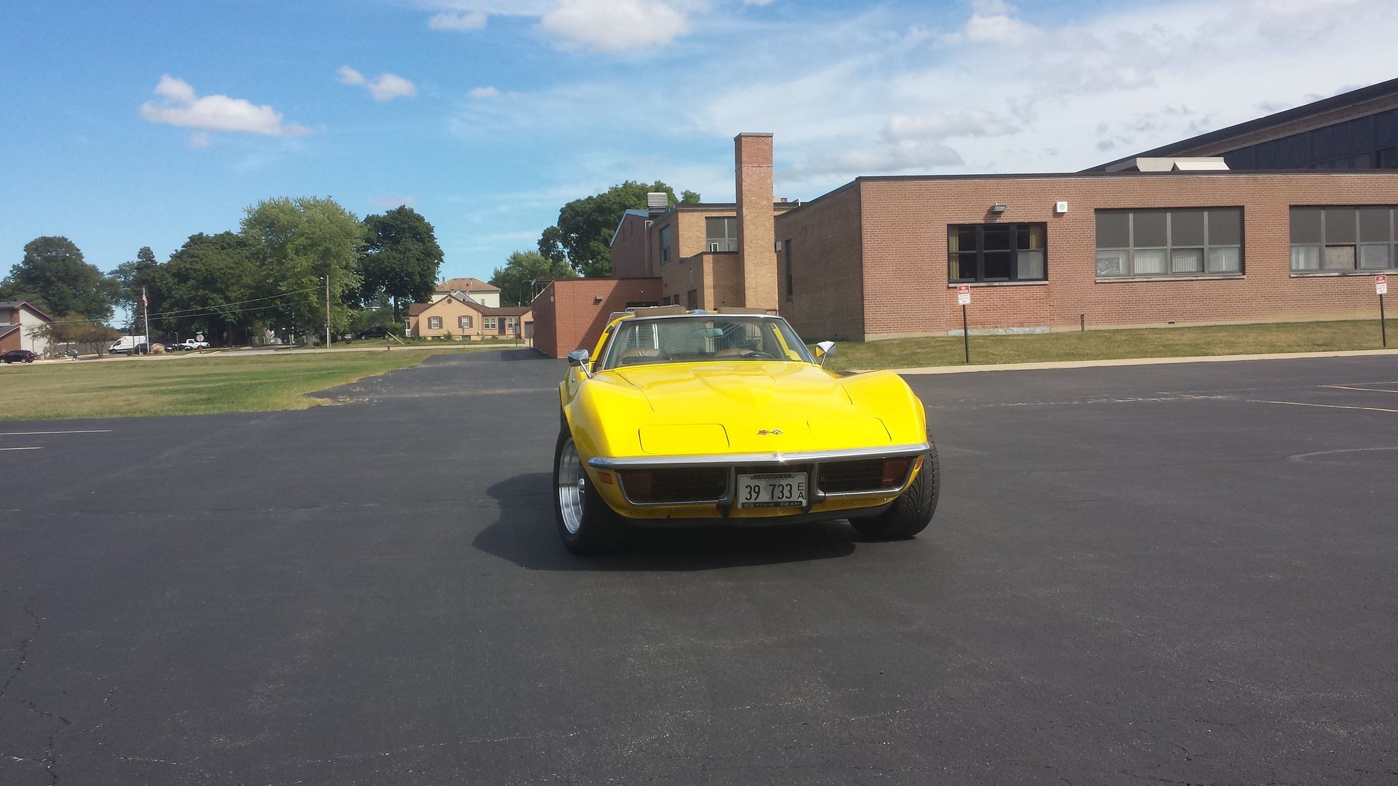

I added one to my 69 convertible strictly for safety since most of us have grown into having the added feature on more modern vehicles. the fact that it adds symmetry to the appearance is an added feature, lol. Alan, i disagree with it being a dangerous addition. seeing as much as possible around you and recognizing that there might be something on the right side should only cause additional caution. if something appears in the mirror you should be exercising caution regardless. just my opinion however.

I mounted mine using the template provided which is exact to the drivers side and works great, I can see the lane to the right of me while driving and I can back my car out of the garage even when my wife doesn't park my truck correctly in the driveway and navigate just fine backing up along side my truck without turning my head backwards... just a flat mirror and I can adjust to see to the rear right side just fine
