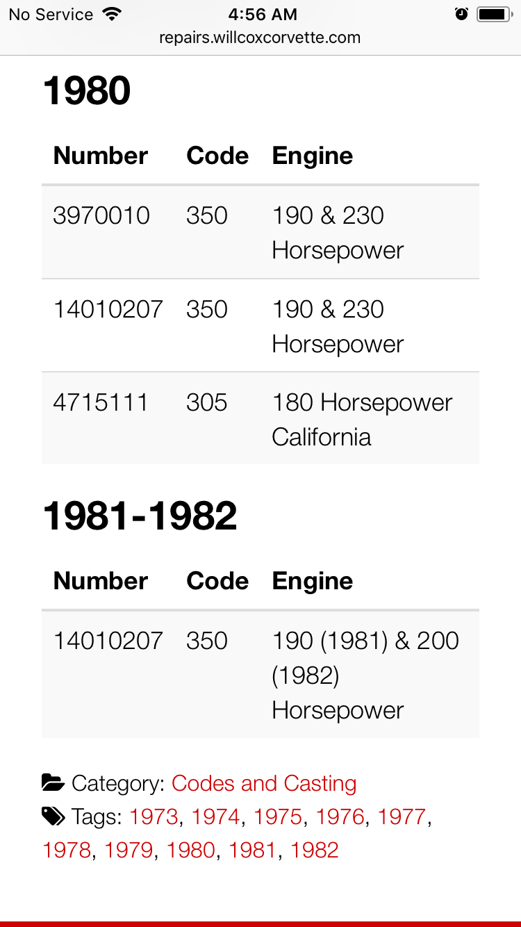

I believe you have the 80-85 truck 350 and the "1" in the casting number is not visible due to casting anomaly......not uncommon on GM blocks to have missing or faint number on the pad as well as other places.

i found this from Wilcox, apparently the were truck/car and actually used in the 1980 Corvettes. I truly hope this is correct.

-Dipstick on the passenger side, right?
CF Lore says that there was a 4 bolt version and a 2 bolt version of the 0207 block.
I found some more internet lore that says that the 0207 blocks are a bit lighter/ thinner and more crack-prone and mark the switch to the made in Mexico blocks.
https://www.corvetteforum.com/forums...4010207-a.html

My 1980 block (L48, numbers matching, factory manual) is block code 14010207. Passenger-side dipstick as Adam said (I thought it was a year thing, as my 79 has it on the drivers side). Now I'll have to stick my borescope in the oil pan and see if I have 2 bolts or 4.
