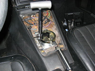

Originally Posted by 70 LS1
Matt, do you have a pic of the modified shifter? Glad to see you finally finished up the interior.
Here you go. It's a couple of pieces of 3/8" steel welded to a Pro5.0 shifter and an original Hurst stick bolted on.
It looks like you chopped the top off the Pro 5.0 to fit under the console??
Yup. That's why it took a few years to finish the console.
