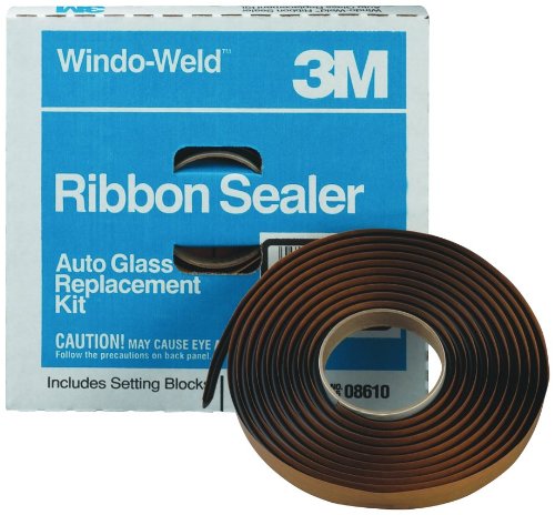

I'm worried by you using the term "glue". A C3 windshield is not glued in, it sits on a rubbery caulking that never hardens completely, called a "ribbon seal".
This is what you need. It comes in different thicknesses. I used the 3/8" version, some prefer the thinner 5/16".
