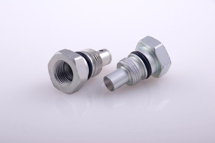

Originally Posted by rpoL98
I installed a Turn One power steering pump flow restrictor, PN1115. As advertised, it did reduce the feeling of being overboosted, and the steering now gives me better road feel, my C3 no longer feels "skittish". When I swapped out the fitting, I lost about 8oz of power steering fluid, to be replaced after the high-pressure hose has been reconnected. The orifice in the take-out fitting is .116", as measured with drill bits. The orifice in the Turn One fitting is .092", which represents a 40% reduction in cross-sectional area. So far, so good.
https://www.turnone-steering.com/col...low-restrictor
update:
the 0.092" orifice, although good for road feel, had some chatter with hard steering movements. I drilled it out with a #35 drill bit, ostensibly 0.0110", measured the drilled hole with a hole gauge at 0.0109". results in a 40% flow increase compared to 0.092", but a 16% reduction compared to the original 0.116". steering seems to have a light feel, again. darn. Maybe shoulda gone with a #39 with 0.995" hole, 17% flow increase over Turn One 0.092", or a #38 drill bit with a 0.105" hole, 22% flow increase over 0.092".
I also noticed that when I purchased my original Turn One flow restrictors, the were stainless steel. nowadays, they're anodized aluminum. Previously, they weren't available with an AN-6 outlet thread, so I had to use a Russell adapter, which is only avail in aluminum. Now, the Turn One flow restrictors are available with AN-6 outlets, in aluminum. "six of one, half dozen of the other."
what can I say, my projects move slowly (2019). Glacial speeds.
