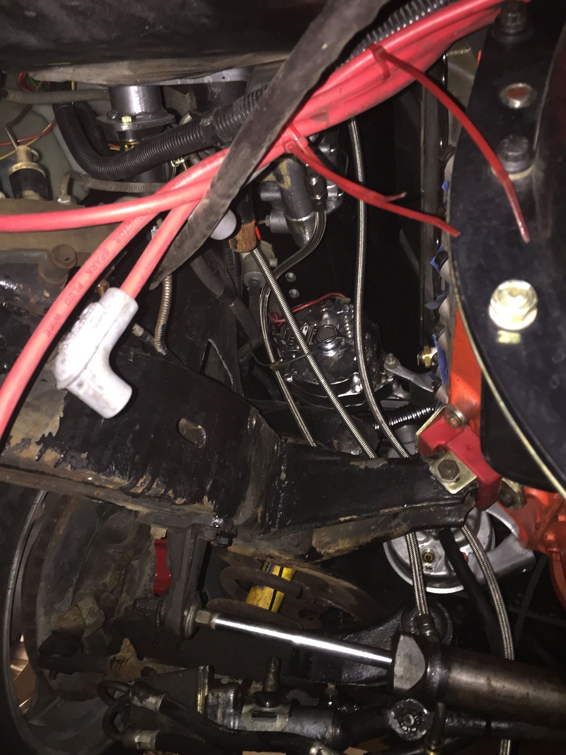

I agree with Hofs01, if you're planning on removing the old box and installing the new Borgeson from the bottom up you'll need to pull your header. But I was able to remove the old and install the new from the top down so I didn't have to touch my side pipes. I did however loosen the master cylinder and moved it to the side, but I never disconnected it so it went right back on, no issues with the brakes.
Anyway, here are some pictures I just took. The only thing I still want to do is reuse the metal bracket from the original rag joint on my new hybrid rag joint (I used the original column side with the new box side) I've heard a few complaints on the new jag joint and I think the problem might be the lack of the support bracket the old one had tying the two shoulder bolts together on the back side.
