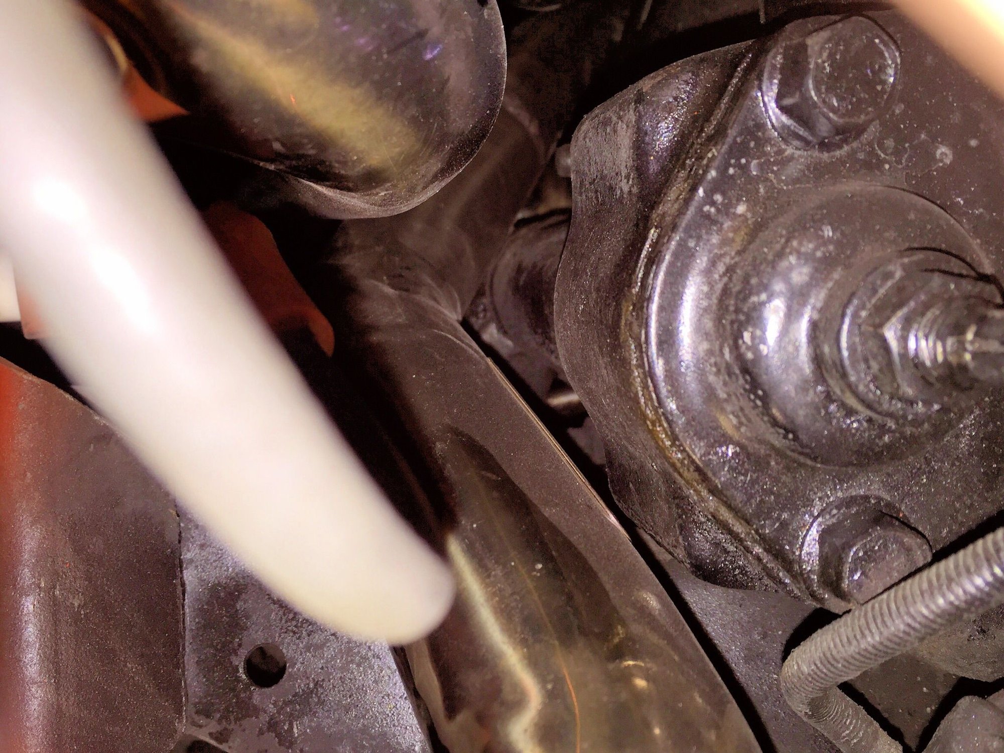

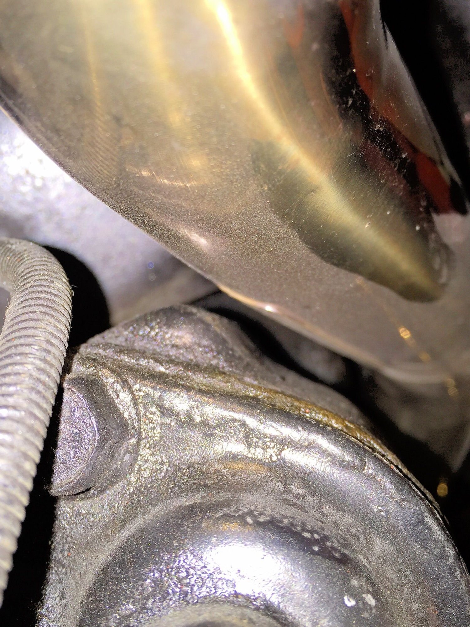

Originally Posted by samdjr74
What brand of headers do you have? I have Doug's and no dimpling was needed. In fact with the new taller steering box I actually have more room between the box and headers.
I have OBX, Hooker clones supposed to have the same bends as the hookers too. (Pardon the dust)

New box arrived today. I did a test fit just to see where I needed to dimple my headers and guess what, it dropped right in, no mods nended! Adjusted th steering shaft length a few times and the new box is installed, its bolted in and attached to the steering wheel but that's it. Suspension needs to go back on before I can hook up the rest of the steering.

So in case anyone is wondering or doing a search:
OBX stainless steel side pipe headers and a Borgeson Box fit a c3 corvette (1971 at least) small block without modifying the headers. I know I tried searching for this answer and could not fine one. I even sent Borgeson photos of my old box and header with less then 1/4" between them and they told me it would not fit without modifying the drivers side header. The new box is taller and there is much more room between them now. I'll post a pic later.

Great post, let me add to it.
The Borgeson will fit in a 1980 running the stock engine with no modifications needed to Doug's side pipe headers.
