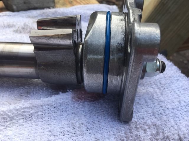

I don't think that shaft is copper. I doubt it could even be bronze. The nut gets torqued to over 150 lb-ft that goes on that shaft (this is not the correct number, don't cite it). Is it possible that someone used copper anti-sieze on it? Perhaps before Borgeson rebuilt it? Is it magnetic?

yeah that's why im kind of fixated on it... it's not a surface coating because it cut with a knife. It's original and ive seen it on other members steering boxes on here as well. Yeah I havn't done the easiest test yet of the magnet... but im still reaaaaaaaaaaaaally curious why there is copper on it... or some kind of alloy

Originally Posted by jpattt24
I pulled the sector shaft out today and found that the o-ring was perfect. but the bore in the box where the o-ring sits has a bad galge in it. as seen in pic. I put a new o-ring on it and cleaned it up good. put it back in car and it still leaked. im sending it back to jegs and they will credit me. I got a new one on the way should get it tomorrow afternoon via ups. and I will get it on the vet Saturday. hope this new one is good. also the o-ring in that kit was way to big ?
I got new box in the mail. I cleared it as some
one suggested and it turned out nice. hope it don't leak like the last one.

[QUOTE=Bikespace;1598464079]I don't think that shaft is copper. I doubt it could even be bronze. The nut gets torqued to over 150 lb-ft that goes on that shaft (this is not the correct number, don't cite it). Is it possible that someone used copper anti-sieze on it? Perhaps before Borgeson rebuilt it? Is it magnetic?
Could the shaft be Nibral?
Nibral is an alloy in the marine industry for underwater hardware.
