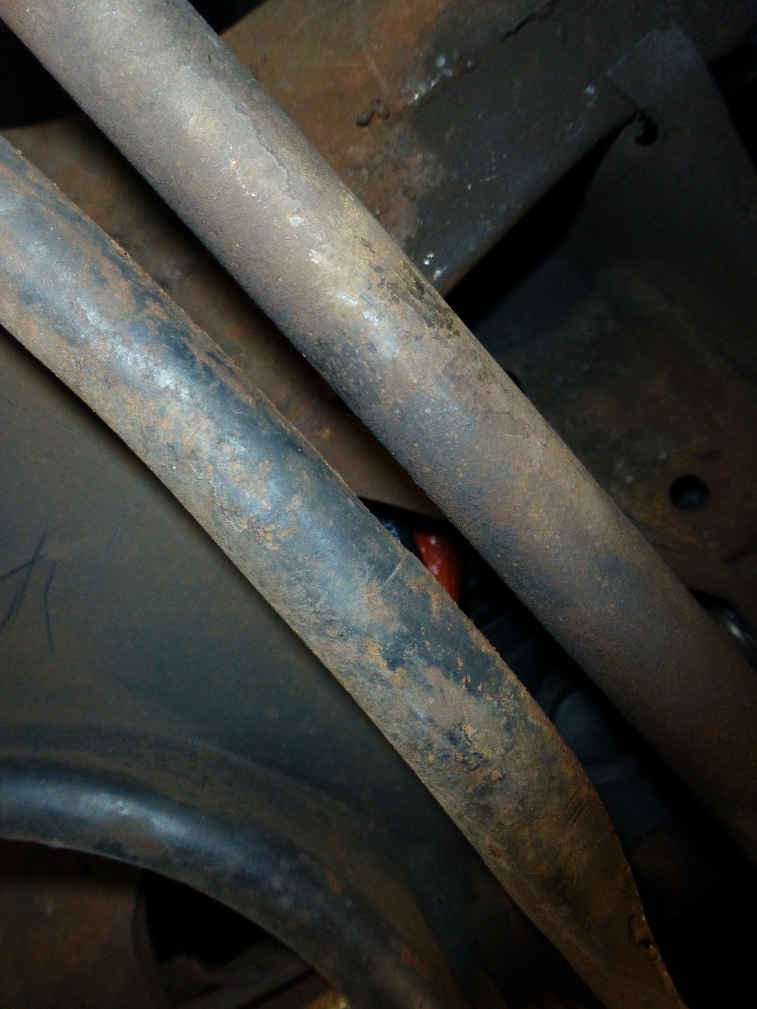

JP, when you get it all installed let me know if you have any clearance issues between the drag link and the driver side lower control arm. I had about 1\16", not enough for me. Had to clearance the a-arm etc... Looks like a shorter Pitman arm is needed. Still, it works and feels good. I wouldn't change for a r&p.
Mine has about a 1/4 "but not hitting the control arm. im gonna try it and see if it hits hope not.
mine has about a 1/4"
