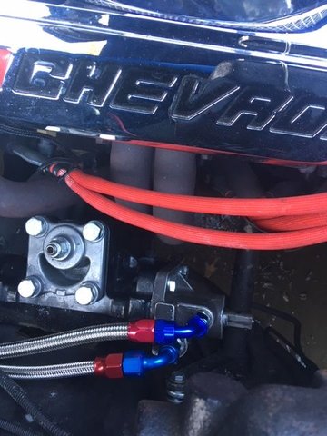

I used the old column flange and clocked it where it needed to be for the steering wheel to be straight and the blinkers cancel correctly now. and I had to grind a new flat spot for the pinch bolt. and now I can move flange on shaft real easy to get it in the correct position. and all is good now. the borgeson flange is a real tight fit and once its on the shaft there was no adjusting it without a hammer that's why I used the factory flange. now I just need to mount the new column.
To Borgeson Install

looking at your pic, I hope that's not regular grade braided stainless hose? especially on the high-pressure side. needs to be rated for up to 1200 psi, and also formulated for power steering fluid, which will degrade and seep through regular automotive rubber hose (e.g. fuel, water, oil rated). I went with the Earls braided steel teflon lined for my HP side, although the Earls PS-specific hose has a higher pressure rating. and with the regular old PS return hose from the the gearbox to the reservoir. I tried to use the Earls blue PS-specific hose for the return line, but couldn't get it to fit over the hose nipple on the steel pipe on the PS pump reservoir. very frustrating. so had to go with regular automotive grade, but still PS fluid specific.
regardless, glad you got it all bolted together and hooked up. I was reluctant to file a flat on my factory column end, so had to work with the clocking that it came out with. it's one or the other...
Old Nov 30, 2018 | 08:12 PM
  #379
jpattt24's Avatar
jpattt24
Joined: Jun 2016
Posts: 169
Likes: 39
From: Savannagh, Ga
Yes I have high pressure ptfe hose on the high pressure side. and regular braide hose on the low side. thanks

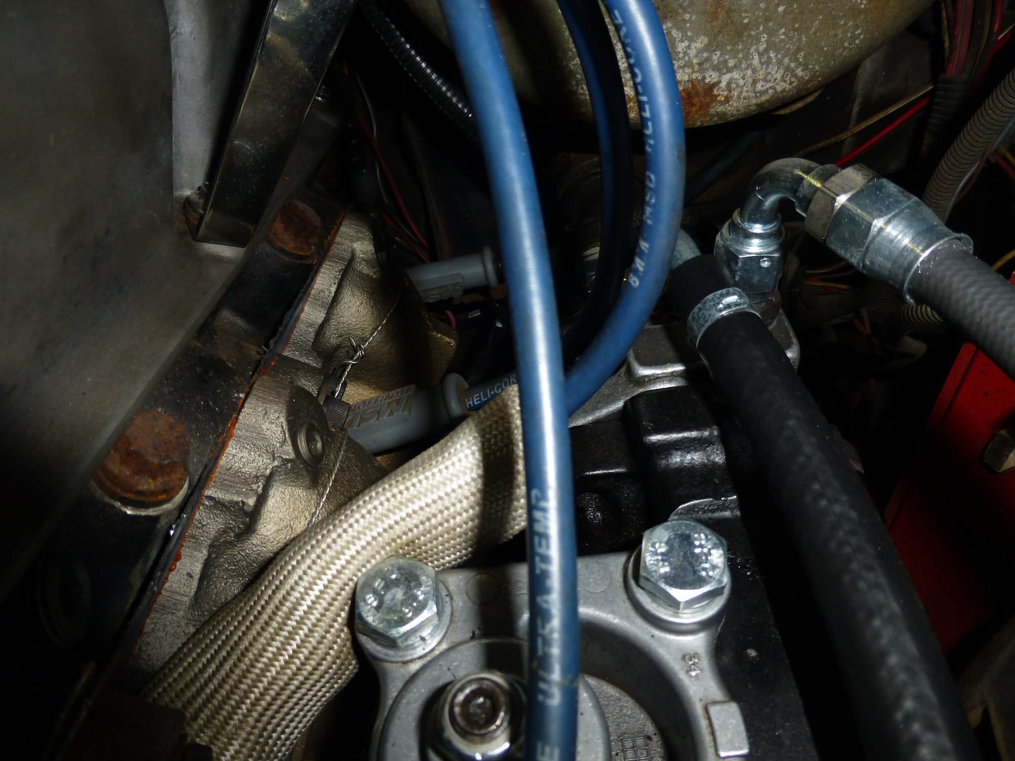

here's a pic. I covered the teflon braided hose with heat shrink so it wouldn't be abrasive to anything.
