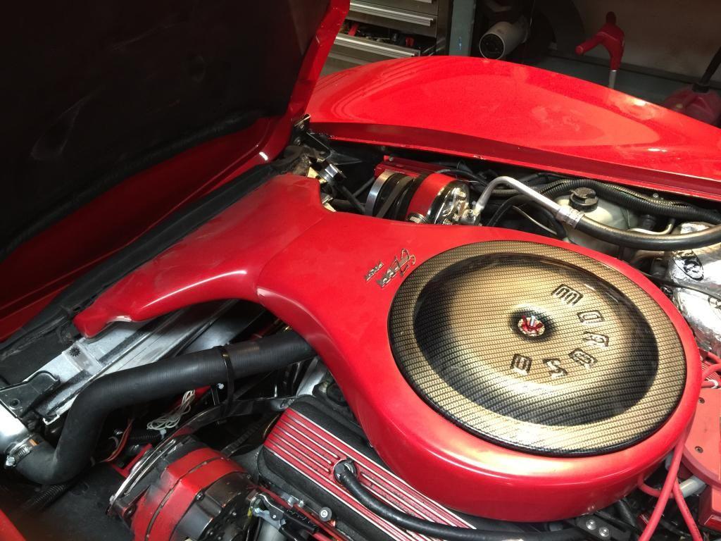

I will tell you that it does require a little bit of work to make it functional, but it is WELL worth it.
You have to mold the air box into your hood with fiberglass. Not too difficult. You will have to trim and fit it and then fiberglass it in. I made mine so the filter could be fitted into the space in the hood with a little twisting, and then used some sealer. The filter is removable and washable.
The cage on top of the Carb is actually an old air filter cover from a harley davidson I had laying around. With a tiny bit of adjustment it fit PERFECT. I used a painted coffee can and a streamer from a Viet Nam F104 era "remove before flight" air intake banner to cover the carb and keep the dirt out when the hood is open.
It's pretty self explanatory. You will kick yourself if you don't make it function.
And I hope you don't mind but I'm using a picture of your car as a background because it will inspire some of the things I want to do to my car. I love yours

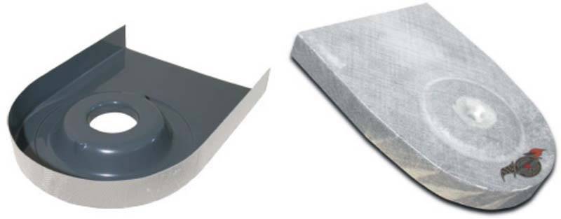

Here are some universal cowl induction air boxes that circle track guys use. I used one similar to their 14" fiberglass one as a starting point and modified it to fit with a my 76' stock hood. Mine looks a little different than this one, but similar concept.
I had to heavily reconstruct the rear portion to clear the HEI distributor, but I managed to get a working cowl induction without changing hoods. Mines not as pretty as quite a few peoples on here, but it does work.
https://pitstopusa.com/c-133064-body...induction.html
