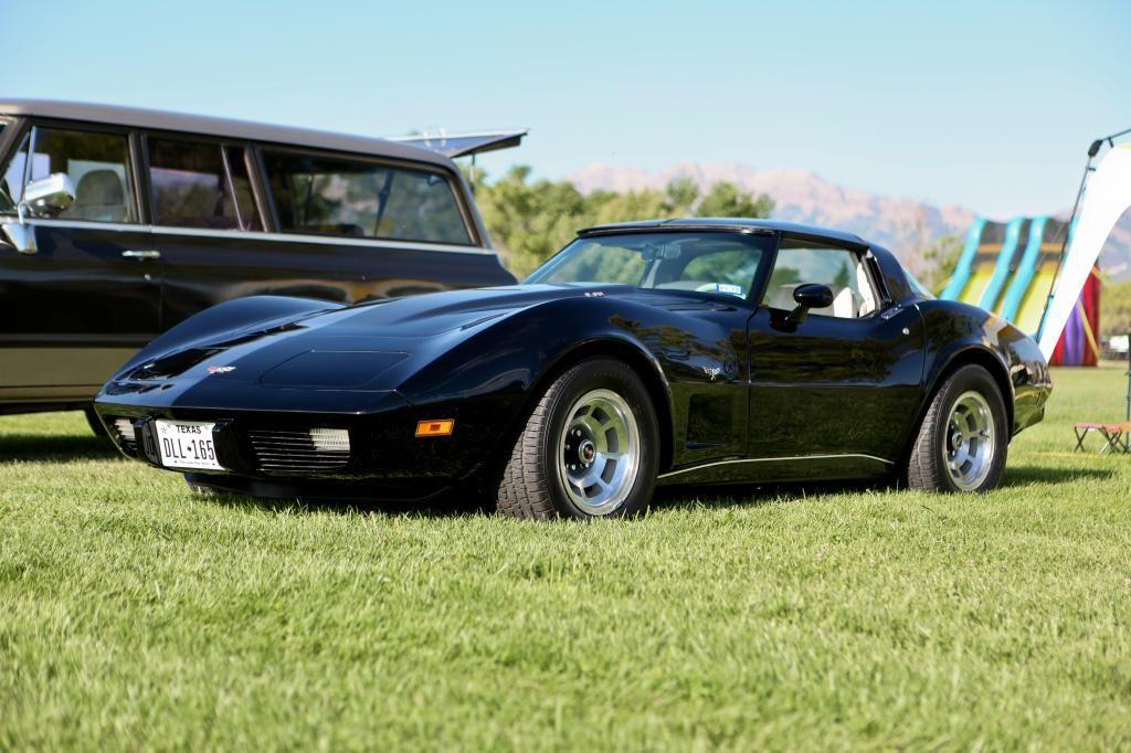

Here is my car at 27 1/4 at the front fender and 28 at the rear with 255 60 15s
Old Jul 8, 2014 | 07:17 AM
  #74
Illegal Vette's Avatar
Illegal Vette
Joined: Apr 2014
Posts: 406
Likes: 22
From: Lyons Colorado
My first Vette looked exactly like that!
