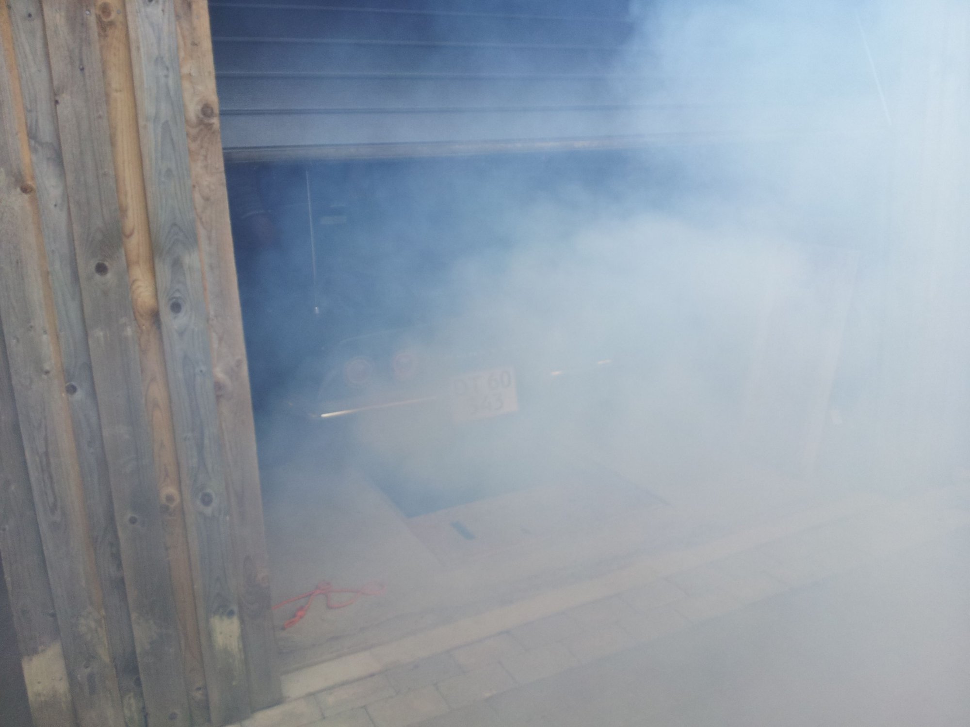

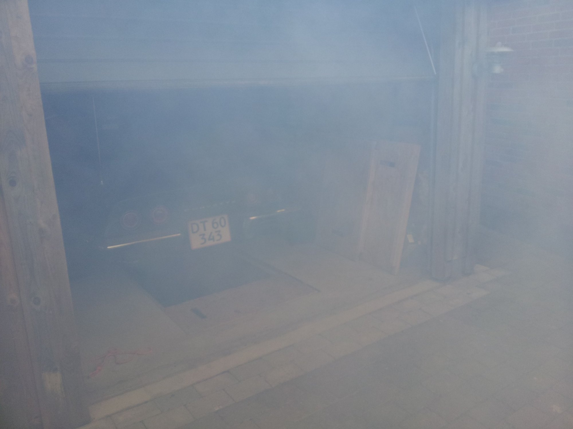

Old Aug 3, 2014 | 05:46 AM
c3_dk's Avatar
c3_dk
Joined: Jan 2008
Posts: 3,795
Likes: 435
From: Aarhus, Denmark
Please see Pictures
Old Aug 3, 2014 | 07:20 AM
Danish Shark's Avatar
Danish Shark
Joined: Aug 2008
Posts: 878
Likes: 55
From: Deep South Denmark
Well that's a "little" more smoke than what's acceptable
In the picture it looks blue to me? It's easy to smell if its burning antifreeze and the same with gasoline smoke. To bad smells can't be transmitted over the internet, right?
I'd start by removing the intake and see if there is oil in the intake runners (to check for leaky intake gaskets).
Old Aug 3, 2014 | 07:21 AM
c3_dk's Avatar
c3_dk
Joined: Jan 2008
Posts: 3,795
Likes: 435
We just removed the intake, there is oil in the runners !!
That is why we took some pictures, so you all could see the color.
