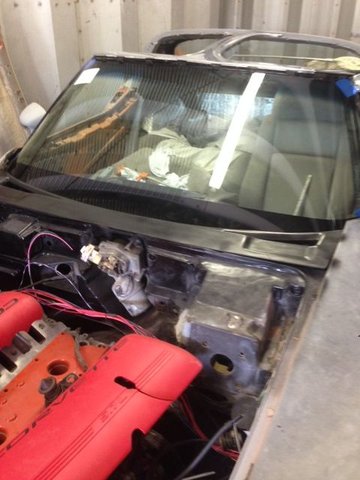

Just pickup my windshield, Its setting in place but will start on it tonight...

well The glass will fit great but will need to go to 3/8" spacing from the pinch weld to the glass. Once I switched my test spacers to 3/8" the trim fit just like it should (against the glass). I now need to find some 3/8" damming strips. The 1/4" will be a little thin...
