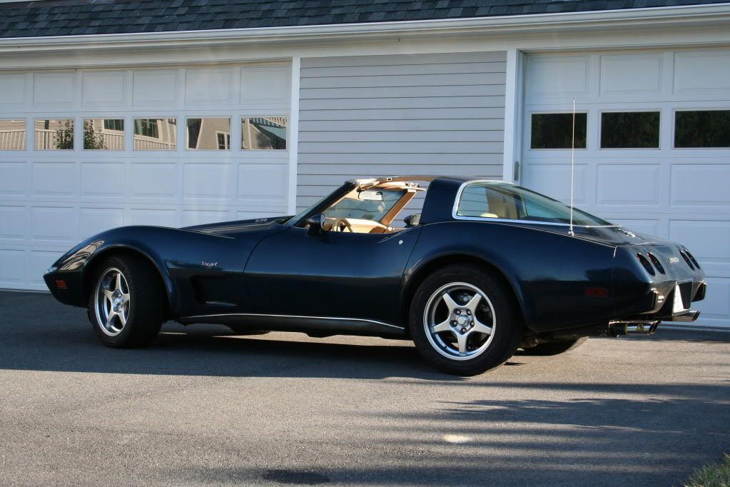

I have 550 front springs and a 360 mono spring rear with Bilstein HD's in front and Bilstein Sports in the rear. The car rides BETTER than the OEM gymkhana suspension-by far. I have also been in 78 base suspension cars with the very soft rear 9 leaf steel spring and the base front springs and the car bounces all over the road. My combo is the recommended replacement front and rear springs from most vendors for cars that originally had the sport suspension and I noticed no difference in the front with 550 springs versus the GM springs in terms of ride harshness. The recommended replacement front springs for base suspension cars is 460lb springs. 550 springs are NOT for BB cars only and are appropriate for gymkhana cars and the BB cars. The problem with the C3 suspension in general is too soft steel spring rates. My car rides, steers, and handles better than it ever did with the GM suspension. Non corvette owners who have ridden in my 78 cannot believe how good the ride is with the above combo. The height used to be perfect front and rear but with the AFR aluminum heads on the car now, I need to cut a coil off the front springs this winter…
The reason that the 550 springs are really the only replacement recommendation from vendors with BB cars is that not only is the BB engine much heavier than the SB cars but the engine protrudes beyond the front wheel center line which creates a nose heavy bias for these cars-weight distribution front 56% r 44% versus the SB C3's roughly 50:50 weight distribution. My 78's distribution is actually 48%F:52% which is one of the reasons folks often complain that the SB cars oversteer near the limit-better for handling but you need to know what you are doing just like in a rear engined Porsche or other mid engine cars.

I need about 1.25-1.5 inches lower in the front now with the AFR heads. Picture above was before I rebuilt the L-82 with the OEM 882 heads. Do you still think 3/4 of a coil will achieve that amount?

Thanks. Will probably have to go conservative at 3/4 of a coil. Any problem getting the coil back in the control arm pocket correctly after a 3/4 inch cut? I figured 1 full coil would be a lot cleaner and easier but may end up being too much.
