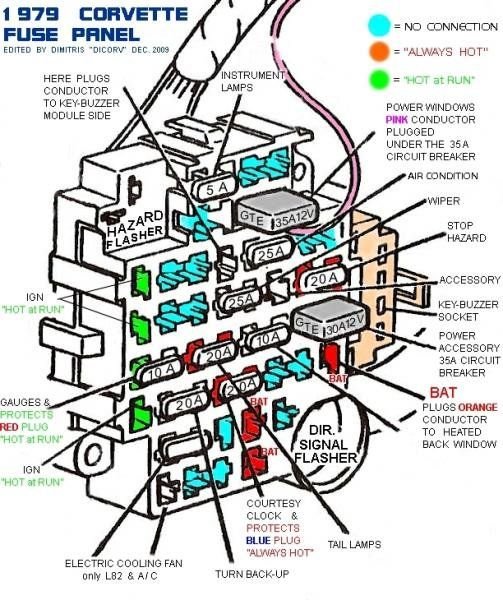

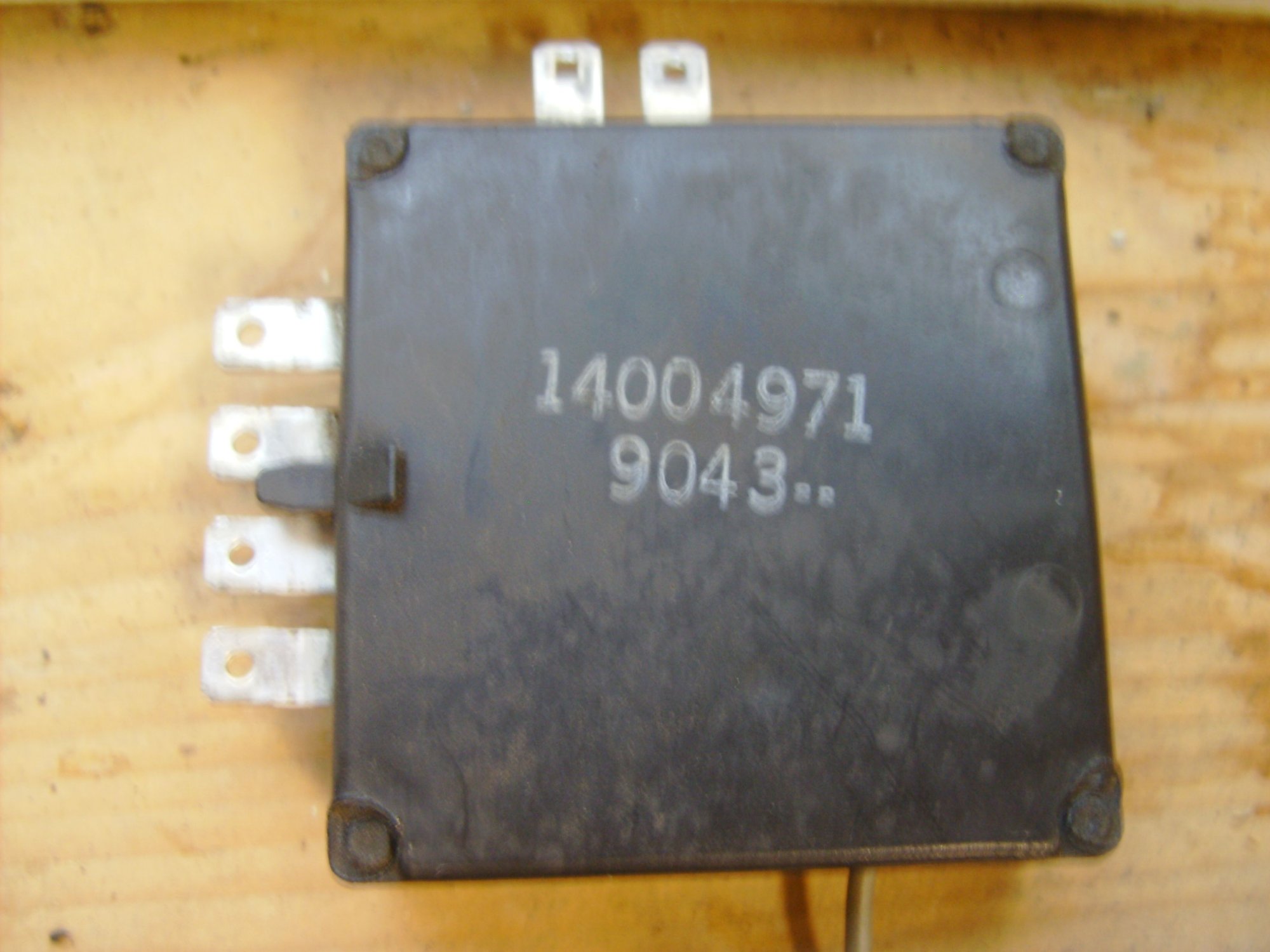

I agree with DUB if the 80 is the same as a79, I have a 79 and this is the chime unit that plugs into the the fuse panel on the right side, the green & orange wire plug into the unit on the two pin side, hope this makes sense.
Chime & seat belt unit, green and orange wire plug on two pin side
Fuse Block, chime unit plugs in where it says buzzer on RT., also shows where conductor from chime unit plugs into fuse block
Fuse panel
