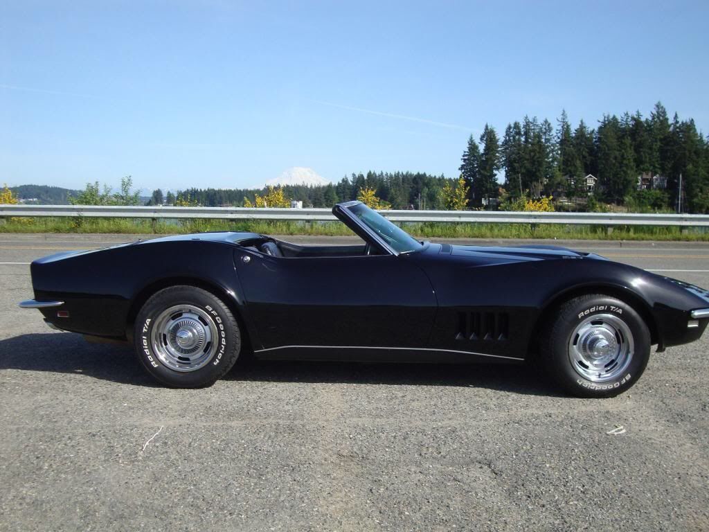

Not to mention the cars... There is a Lars Q-Jet on this old Plane Jane Roadster. And it shreads!

I would not call that a Plane Jane. That is one nice Vette
