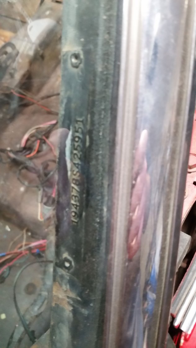

VIN shows it's a 68. Titled as a 68. Most of the parts on it are not 68. No worries. However when I started poking around I noticed this Tag under the hood above the steering column. It has the same serial numbers as my VIN, but claims year '77. Anyone have any ideas on this??
It's a chrome bumper car, so all of the parts on it are 68-72ish.
As far as I know.
Under hood ID tag
VIN plate

Might mean that engine is from '77. What the casting numbers, dates and pad info.

At some point someone installed a 77 350 and put the engine ID and vin on that tag. Obviously changed since then to the present engine.

Your under hood tag is not original to any Corvette. It's from the Bureau of Automotive Repair, whom ever that is?
Your car would have had an engine/emission sticker that looked like this, but specific to your cars original engine.
https://www.corvetteforum.com/forums...n-sticker.html
It was located on the flat spot behind the power brake booster/master cylinder.

Yeah, thats a sticker used by the BAR for engine swaps. Tells the smog check technician what the engine is and what emissions equipment are needed on it. Not sure what state its from but if it a California one its pretty old. I once put a Oldsmobile BB in a 67 Chevy pickup and had to take it to a referee to have it certified, put a similar sticker on the door jamb for future smog checks.
