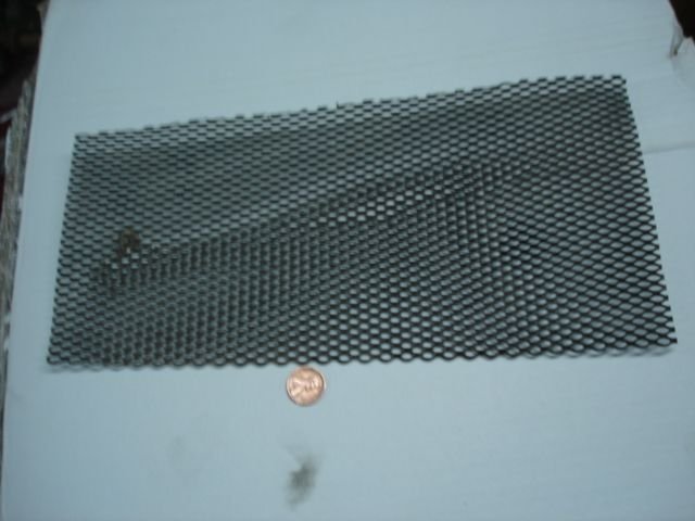

Sorry,,No photos of that project. But I made a template out of piecing together thick paper and then transferring it over to the expanded aluminum screen material that you see behind the custom hoods with openings in them. The I used the black plastic. rubber door edge molding you can get at an auto parts store to make it more refined and that special touch....instead of a cut/jagged edge. Mounting it to the plenum...will up to you.

This is the type of screen I use when making the screen you are wanting to make. Then I edge it in the door edge molding as previously mentioned.
DUB

DUB, I like that method. Just shape it to fit. Or I may just do the screen under the grill. Choices! Tnx!
