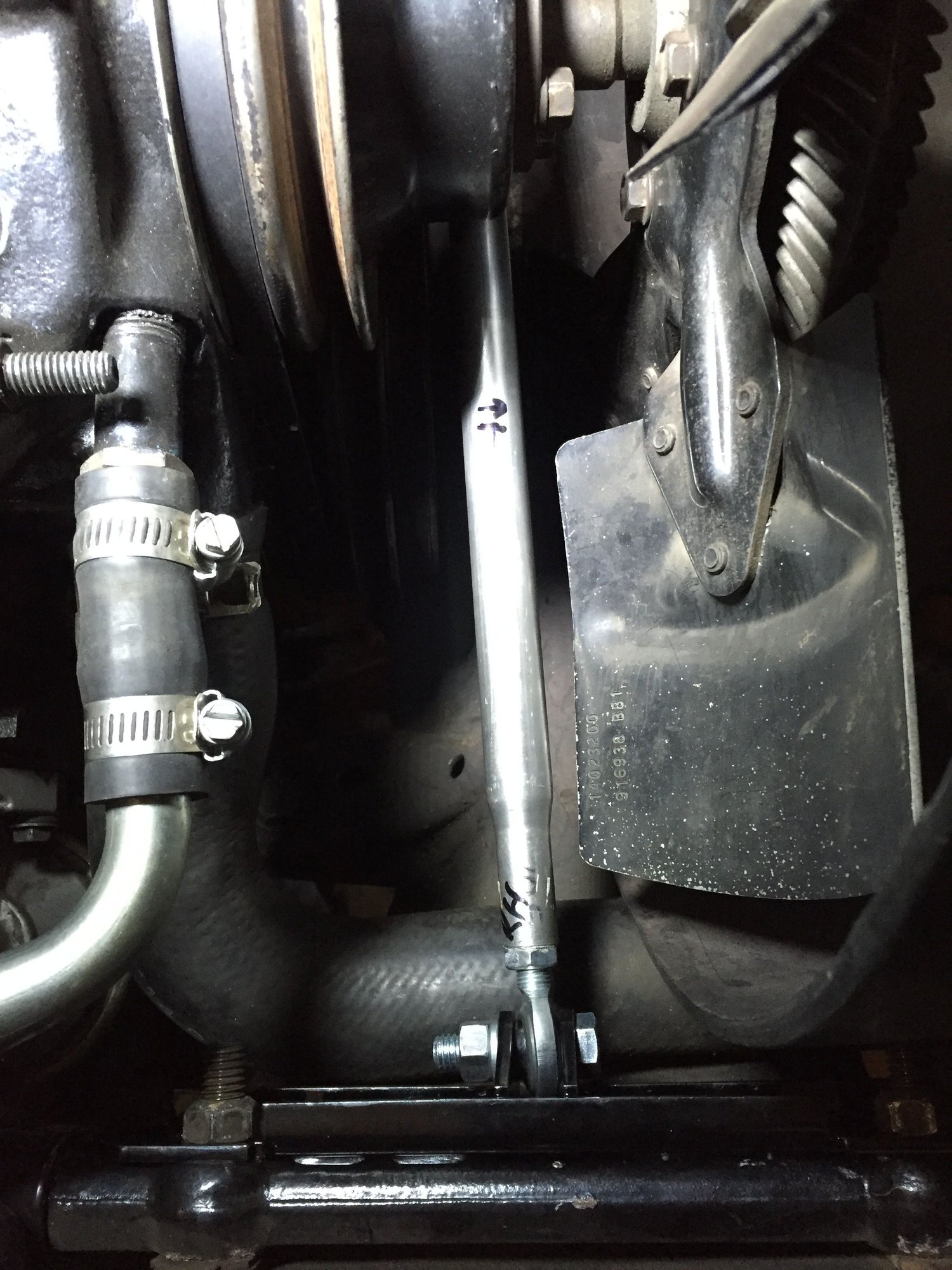

Installed it on Saturday. Pretty straightforward. I think I'll readjust it when I get the car back on the ground. Clearance with the fan was good.
the hard part is sometimes remembering which was is tightening and which was is loosening it.

Thank you for the good Pictures of the mounting Points!
