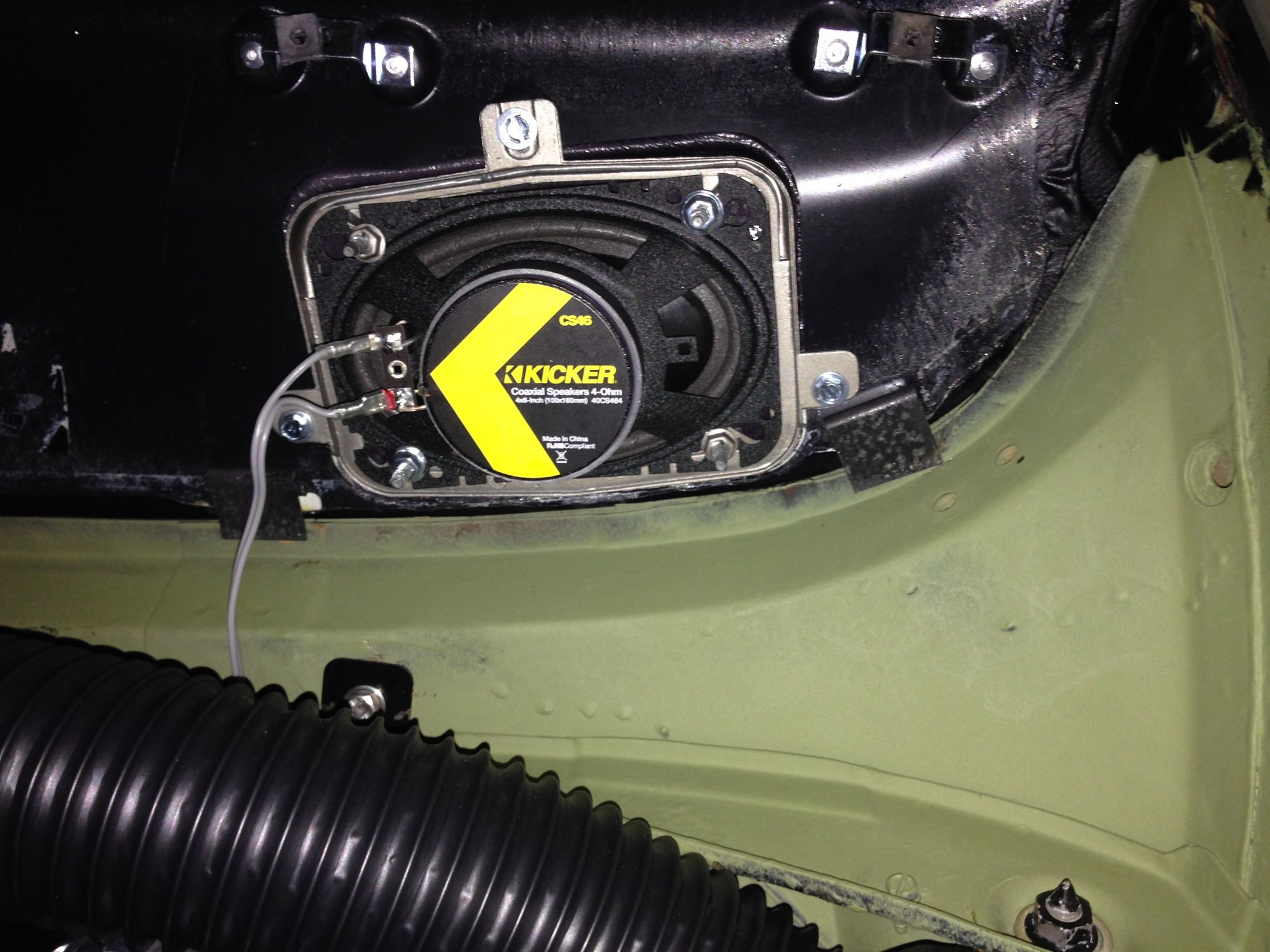

I did it on my 69. Remove the long braces #3 that wilcox shows in the diagram.
The 70 dash has stitching across the front that the 69 doesn't. But I am ok with it.
Get two or make two of the little tiny bookshelf type brackets to support the dash from a 70. Get two of the speaker brackets wilcox lists.
You can just see one of the little braces in my picture below. They go on either side of the defroster vent.
You can see the speaker bracket holding the speaker in this pic. The bracket kinda blocks the speaker a little but they sound good.
