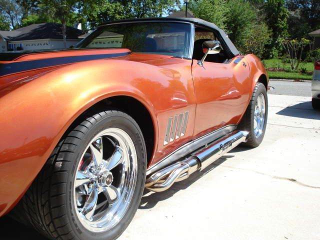

I do all my own work. I The hood design was my idea and turned out good. Had to switch out the inserts in the header tubes, wife was not enjoying the flow through as much as I was. So have reverse flow in the tubes now and I discovered my radio actually works. Thanks again for the updates. Bob
Finished the second paint job
What can I say, I like bling
I have made some other mods since this but you get the idea.

Beautiful car! Love the color, the stripe and the L88 hood.
