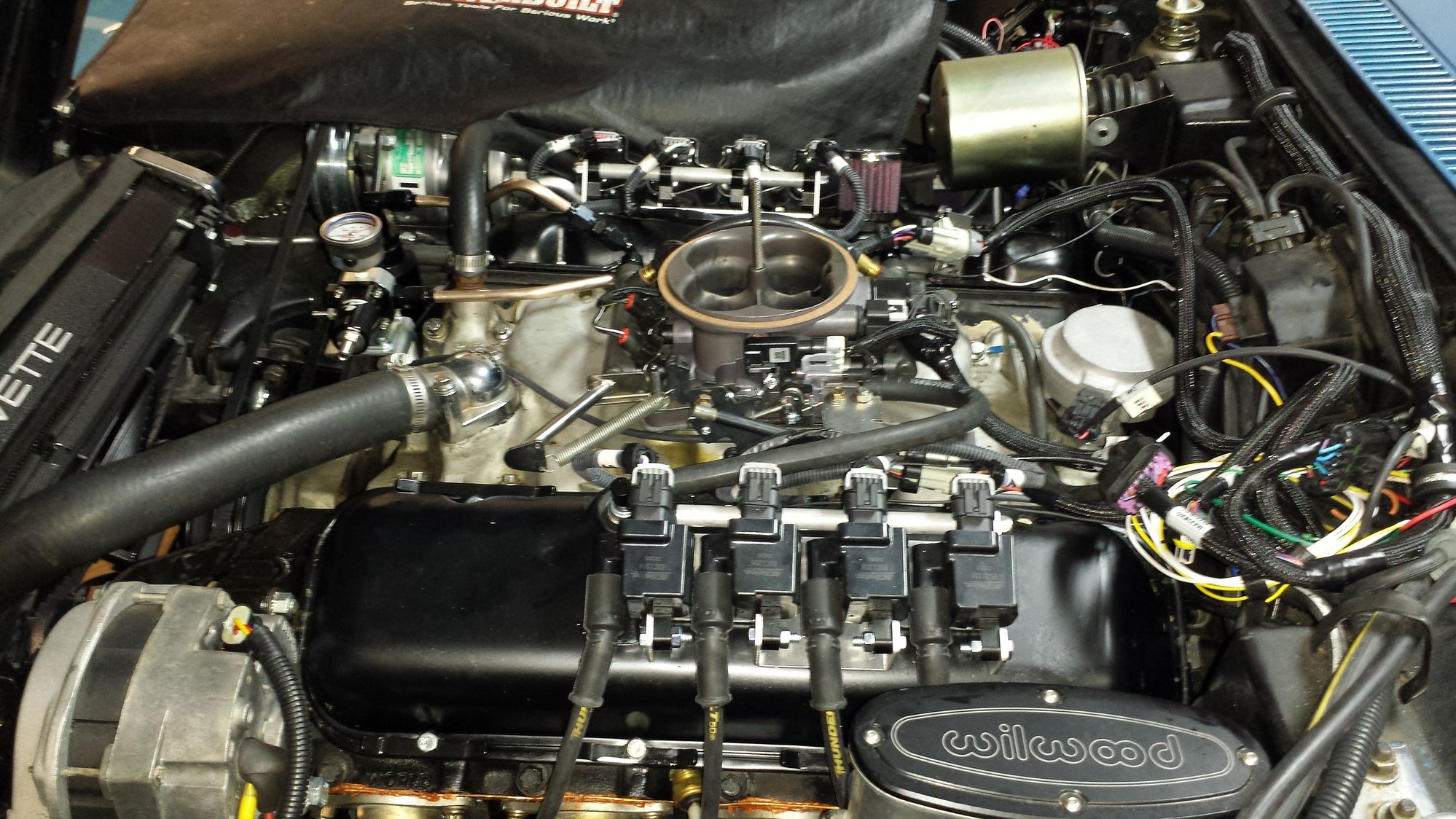

I've recently finished converting my big-block 69 to the Holley Terminator. Hood clearance isn't a problem. In fact it's about 1/4" shorter than the Holley SA 770 carb it replaced. My drop-base air cleaner cleared just as it did with the carb.
I'd really like to move to multi-port injection one day, but I'm not willing to switch to a hi-rise hood so I'm stuck with the pancake LS-6 intake (rectangular port heads). I don't see how the injectors and fuel rails would fit under there.
Ignore the wiring mess!
