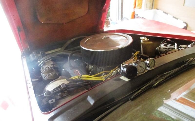

Reading thread's you tell that plenty of people use them.
I have one as a semi-permanent install beside a vacuum gauge and a mechanical oil pressure gauge. I can remove them or swap them for fuel pressure, voltmeter, ammeter, etc as necessary.
These 3 have been in place for over a year though.
Found that what I thought was over rich-idle, was actually over-lean, and corrected a slightly lean cruise condition that I wasn't aware of. So glad I bought it.

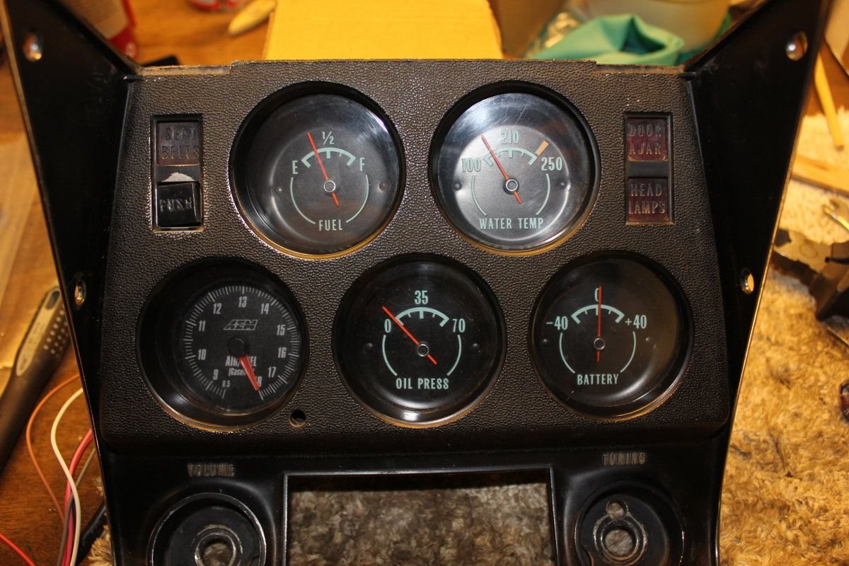

AEM analog gauge in place of the clock:
