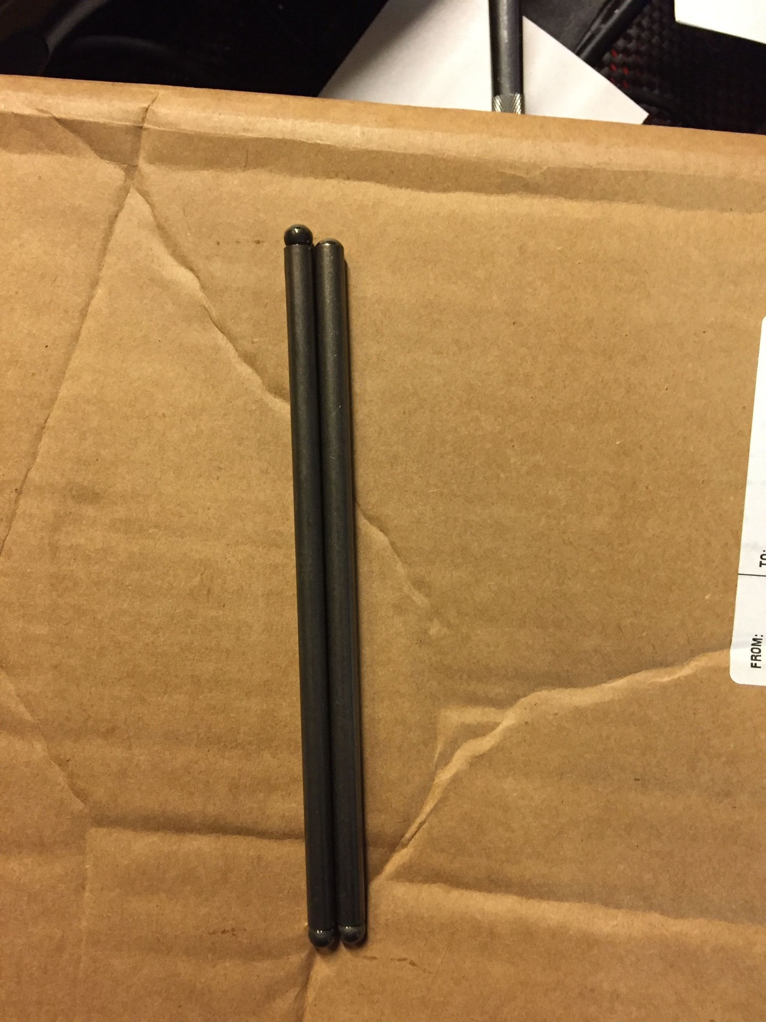

Default Broken pushrod
Broken pushrod. Don't know what cause that. But because of it, the lifter piston became unrestrained and broke the retaining clip.

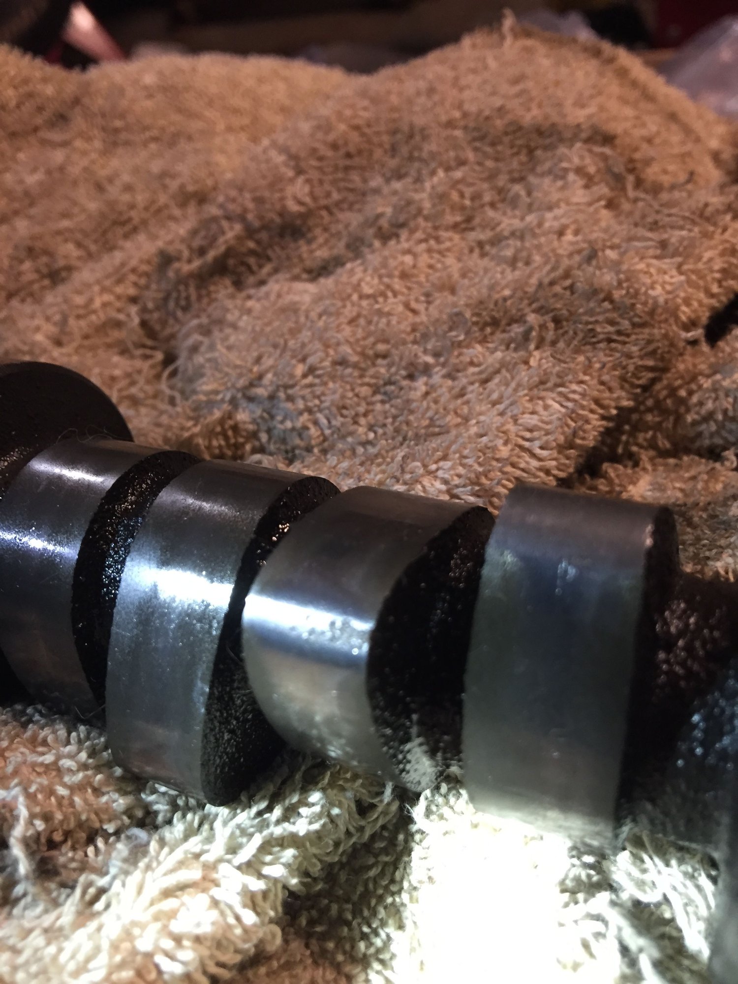

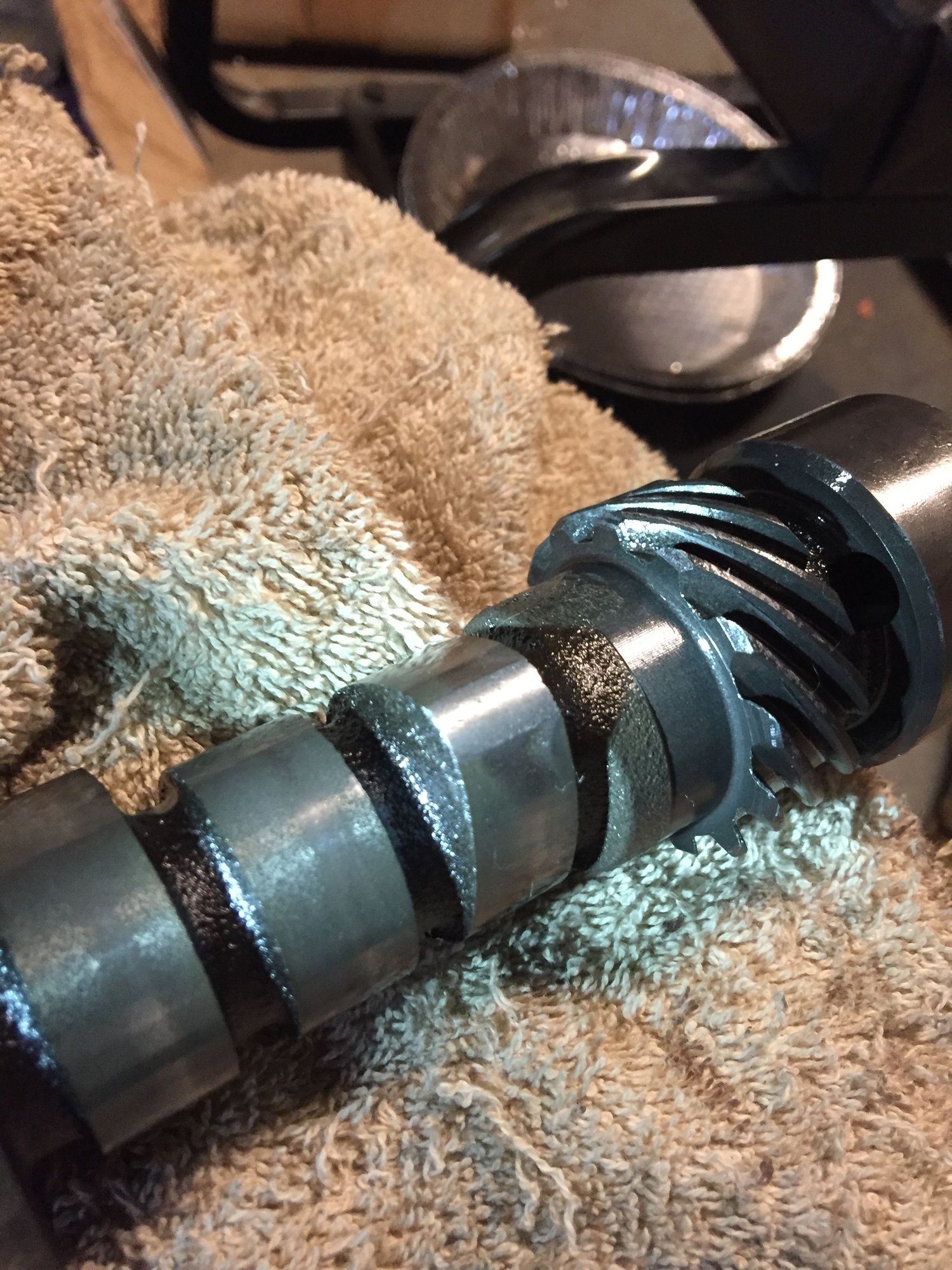

Default Also, cam has some worn lobes
And looking at the cam, there are some worn lobes. They don't look REAL bad, I have seen a lot worse. But they were going bad. Good thing is Summit/Comp has warranted the lifters, cam and pushrods.

I have never seen a push rod do that but I have always bought OEM push rods or push rods sold by the major American manufacturers. Its likely your push rods were made in China like so many other things are now days.

I have seen a few OEM push rods break back in the 1960's but I have never seen the pressed-in and induction welded ball push in like yours did. Just a freak failure but I would definitely use another brand in case there is a manufacturing problem at that manufacturer (China?).

The main thing I noticed in your photos was the LOUSY polish job done on that camshaft. It doesn't look like it had "worn" lobes....just poorly finished quality on them. They appear to have been induction hardened on the lobes, OK; but they should have been cleaned-up and polished after that process. It appears that was done in a half-@ssed way, at best.
Can't say what caused the lifter problem. It doesn't look like the 'odd' pushrod was damaged or broken...it just appears to be 'different'. Maybe they sent 15 correct rods and one that was just wrong.
In any respect, you should get proper replacements from the vendor who sold them to you. And you should NOT have to pay any shipping costs for that replacement. It was THEIR error.
Good luck.
