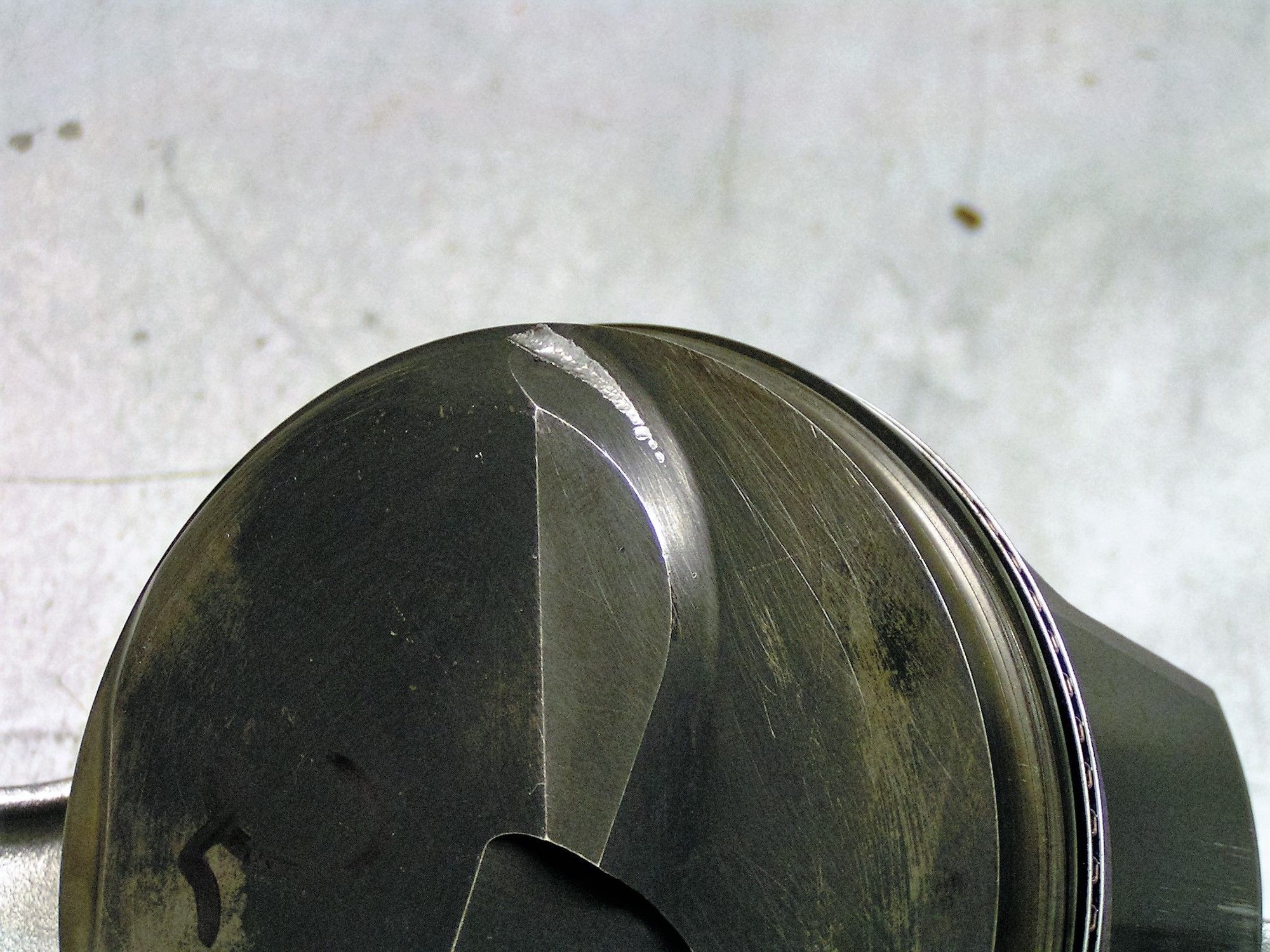

Originally Posted by ddawson
Do you mean the valve to piston issue or the piston is making contact with the head?
Piston dome was hitting the side of the combustion chamber.

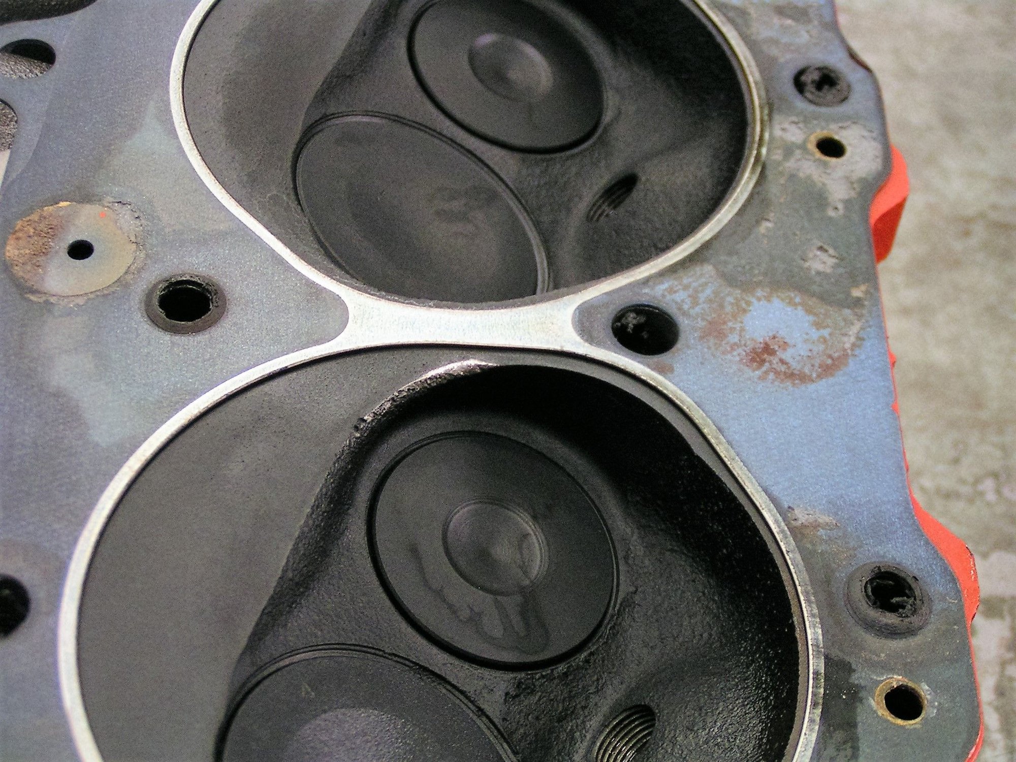

Piston dome hitting head.

OK so are you going to use a thicker head gasket or can the head have material removed.
Can we see a picture?
I had some same issue with my Edelbrock heads that were milled. When doing the math after machining they choose a flat piston.

From: Vasteras, Sweden
Headgasket is ok, as is sqish, just some machining on heads!

From: Lincoln, CA
Wow you got lucky.
I'd polish the pistons as well so get them smooth again.
