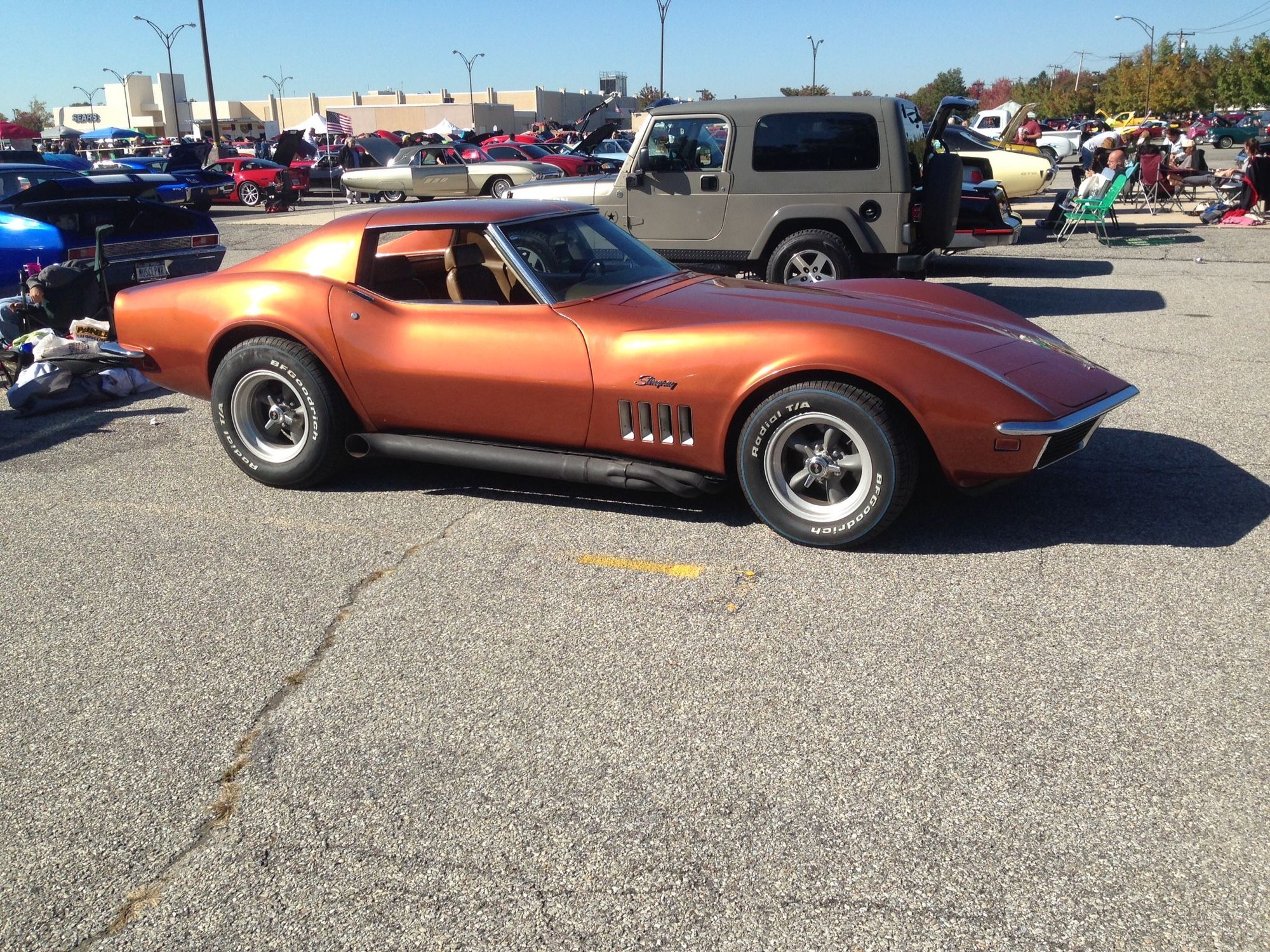

Originally Posted by a striper
15 x 8 and 15 x 10, 245-60-15 and 295-50-15. I notched the trailing arms and it's a tight fit.
Are those tires about the same height? If so, that is probably the sizes I need. Got a side profile shot?
IIRC the fronts are a fraction smaller diameter.

That's about perfect! I love the 200 s Daisy wheels as well. Stock ride height?
I added 550# front springs and removed a bit a couple of times till the front as "there that looks right". I added lowering bolts out back and set it "there that looks right". The stock width rear spring would not work with this combination. I think that it is down a bit but don't have a reference to say how it would compare to stock. With the back up just a bit the tires never touched the chassis. Like this or even a bit lower I get some "shiny spots" on the frame but the tires must just kiss it because they have almost no indication of touching.
Do you have any pics that show exactly how you notched the trailing arms and what is the back spacing on the 15x10's?
Since the bushings and alignment were good I notched them while on the car. The reinforcement extends a couple of inches beyond the opening. I welded it as far as I could thought the opening plus plug welds on the back side. And of course the parking brake cable has to be moved.
