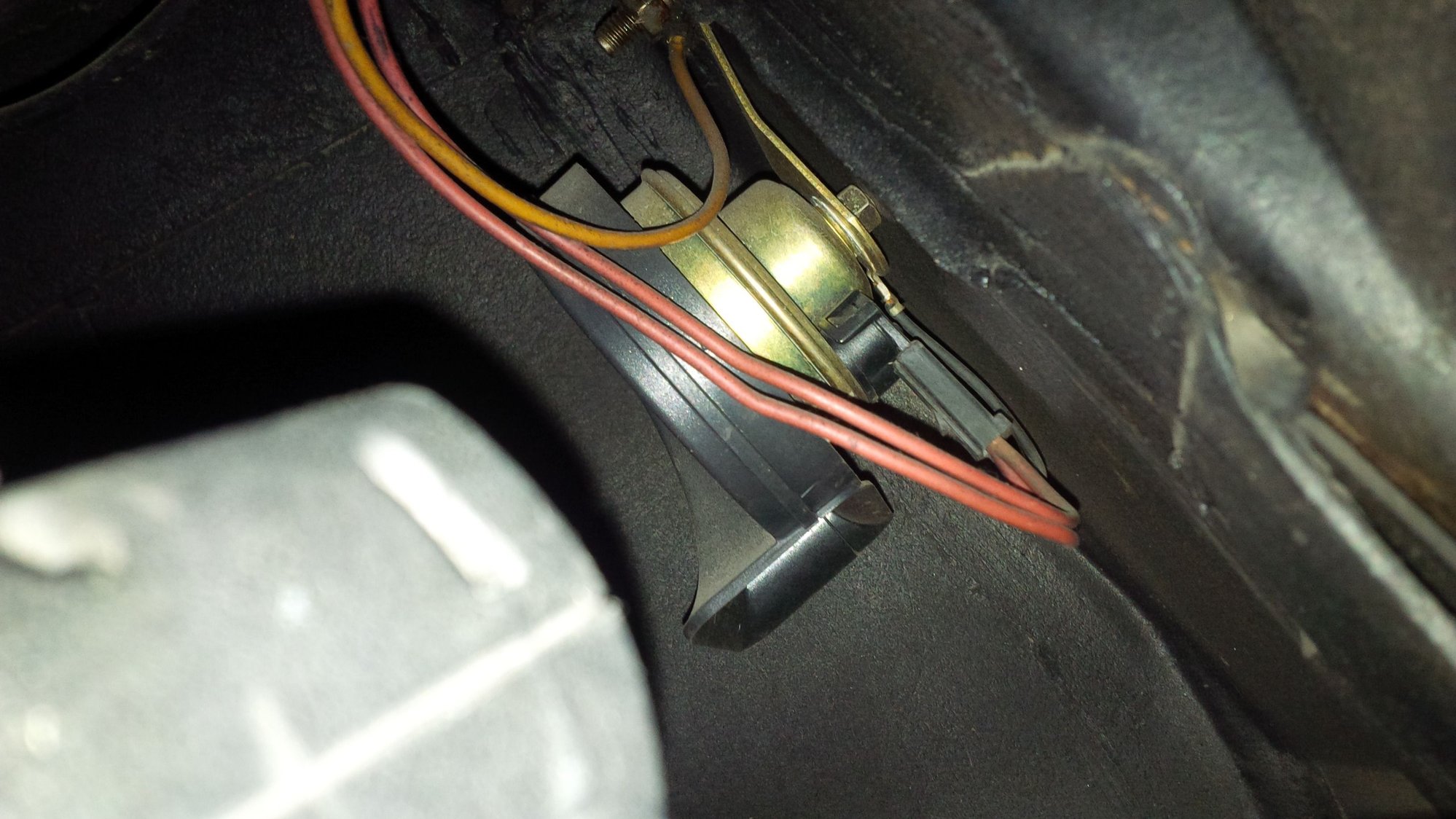

Here is a pic of my key switch:
And here is a pic of my alarm horn; this is a generic parts store horn that I replaced the factory one with, but the wiring is the same:
The pics make the wire colors look a little off, but they are orange and pink. The yellow wire on the top of the alarm horn is the -12v wire, but that's for the next round of testing!
The key switch simply connects the orange and pink wires together in the "armed" state - which is when the key is in the horizontal position. The +12v then leaves the key switch on the pink wire, which then goes to the alarm horn +terminal, and then onto the alarm relay terminal on another pink wire. Look at the schematic again, now the entire +12v side of the circuit should be obvious to you:
When you are finished this testing, and have fixed any problems found, the entire +12v side of the circuit will be tested. If after all that the alarm still does not work, then the -12v side of the circuit will need to be tested.
