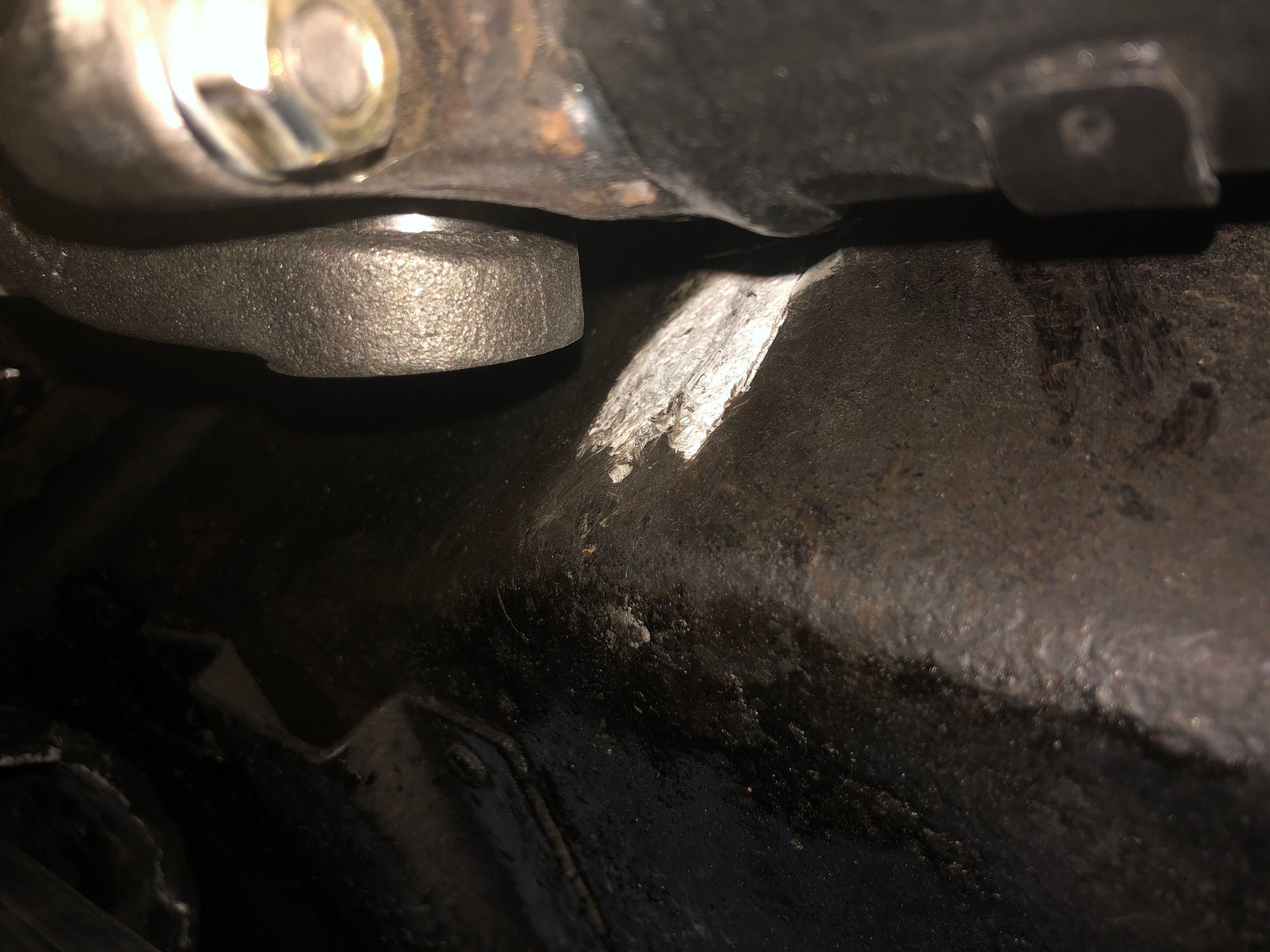

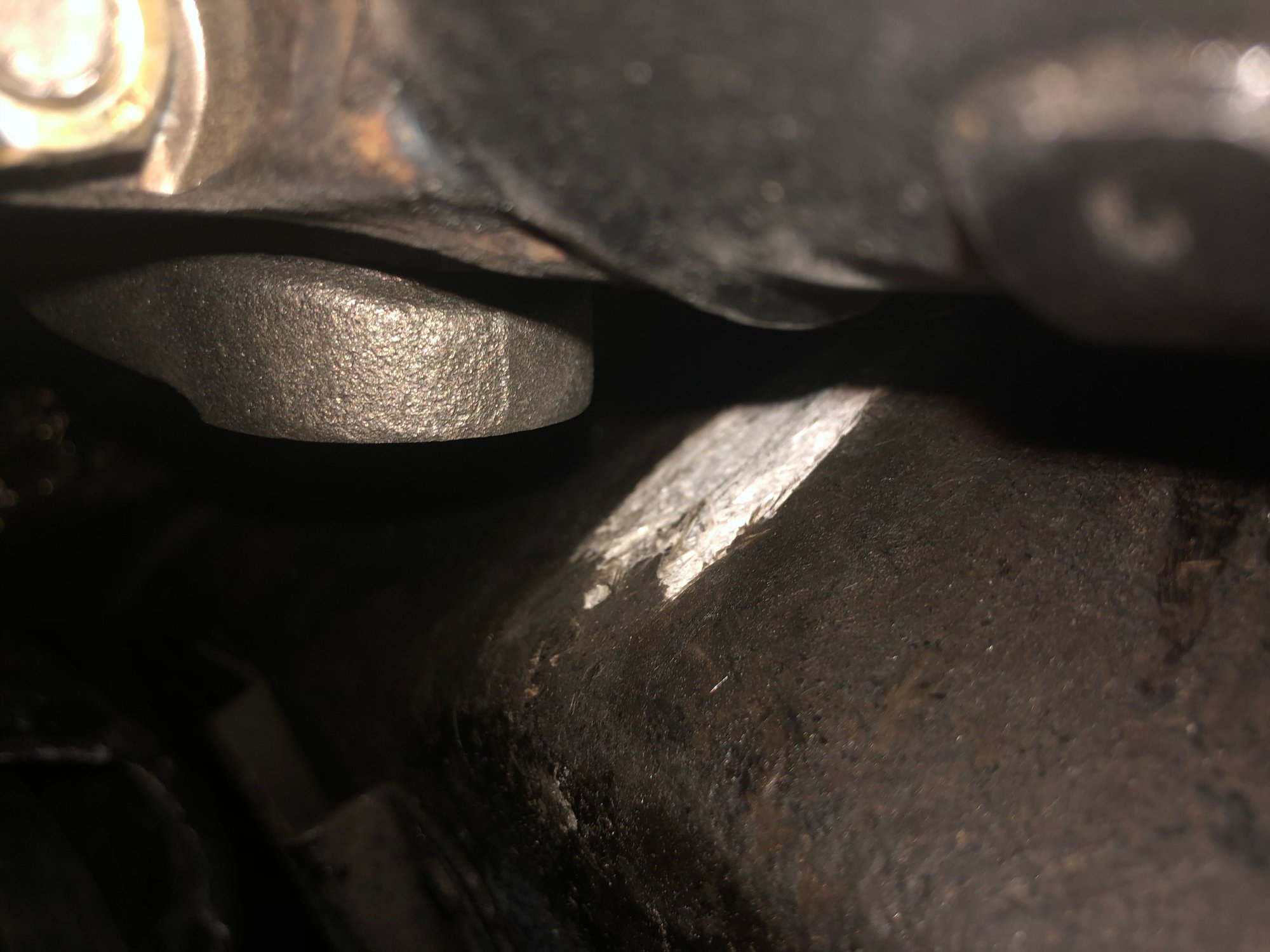

I know this thread is 4 years old but I had a TKO500 installed. I’m feeling vibration at higher rpm’s and when I accelerate going up hill. I’ve noticed the driveline slightly rubbing the tunnel. Do I need to have the bell housing shimmed or do I need to look somewhere else? I can’t get underneath the car to measure the angles but the mechanic said it was within spec. Below is a photo. It is hitting only one side. I noticed this when I took it to the muffler shop but the transmission was resting on the muffler at that time until they changed the exhaust angle. I’m going to paint it and drive it to see if this is the cause of the vibration. I can feel the vibration in the seat and not necessarily the shifter.
