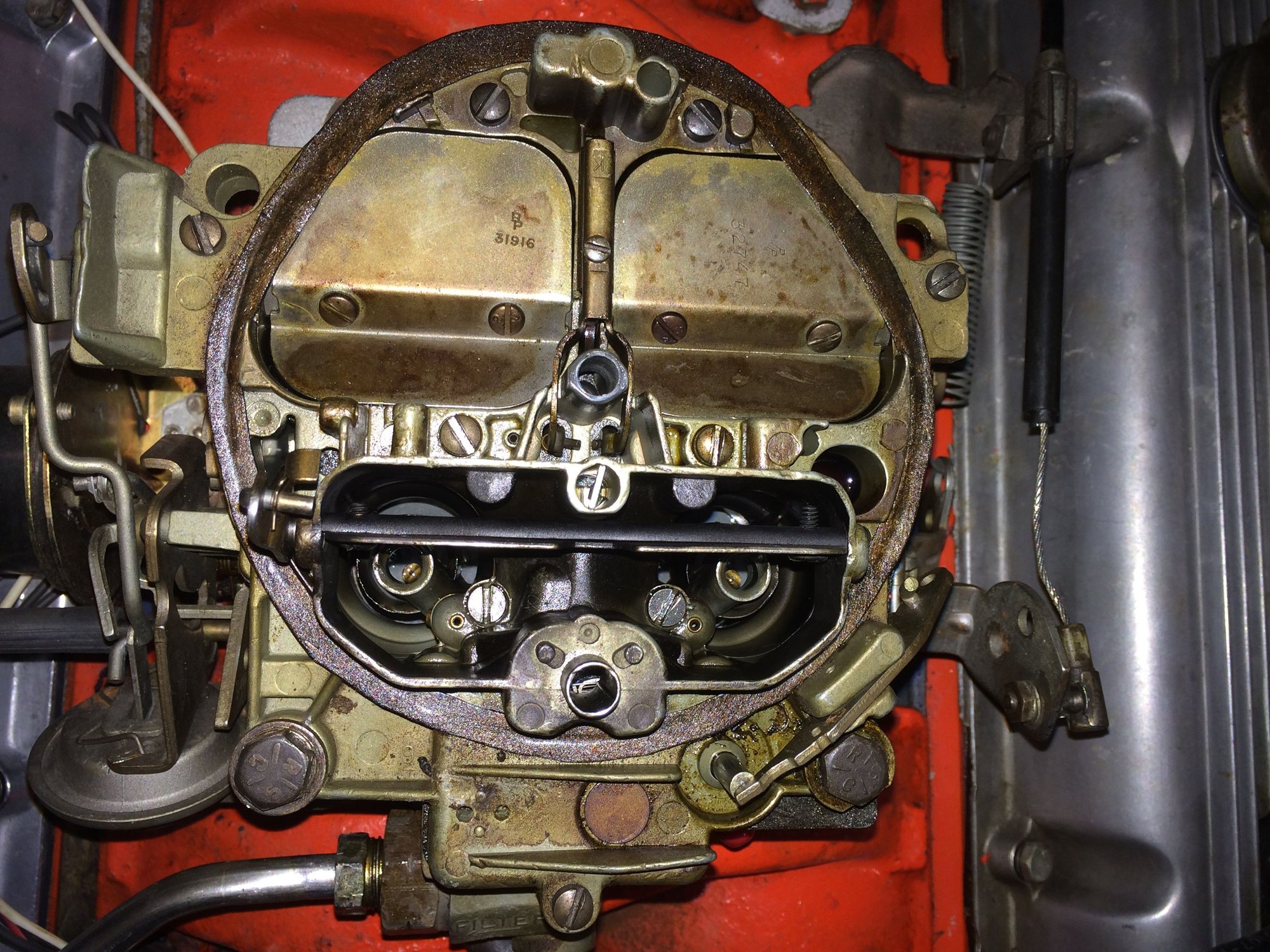

Yeah, unfortunately the carb that belongs on my '70 was a 1-year only, rare sob, selling for huge money! I opted for one from a '69 L46 at a reasonable $425 instead. Works great. From Custom Rebuilt Carburetors in NJ.
If you do rebuild one on your own, you can still end up with problems, as you are definitely not the first person to have taken that carb apart, and have no idea what anyone else has done to it. Wrong screws, warped sections from over-tightening, "drilled" parts, bent parts, worn parts, wrong tubes, damaged parts, wrong springs, floats, cracks, you name it! Study up on it first. Get smart on it before you buy a core. Lots of good gouge on the forum, and other places. Good book by Cliff Ruggles. And of course, Lars' posts.
This was the carb I had when I bought the car. Engine fire waiting to happen.
Just how does this fill with fuel???
Leaks everywhere.
Leaking mess, fire waiting to happen!
Even after I used a quality rebuild kit, I found it was warped, and had a coulpe cracks, and leaked at fuel inlet, where someone had already installed a helicoil. Trash.
Good luck
