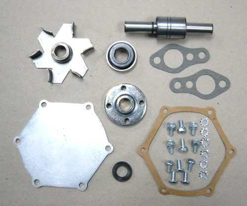

Don't they make a rebuild kit for water pumps?
Apparently someone does...
http://www.classicmuscle.com/p-23351...FYIfhgod54MJsw
Good luck... GUSTO
