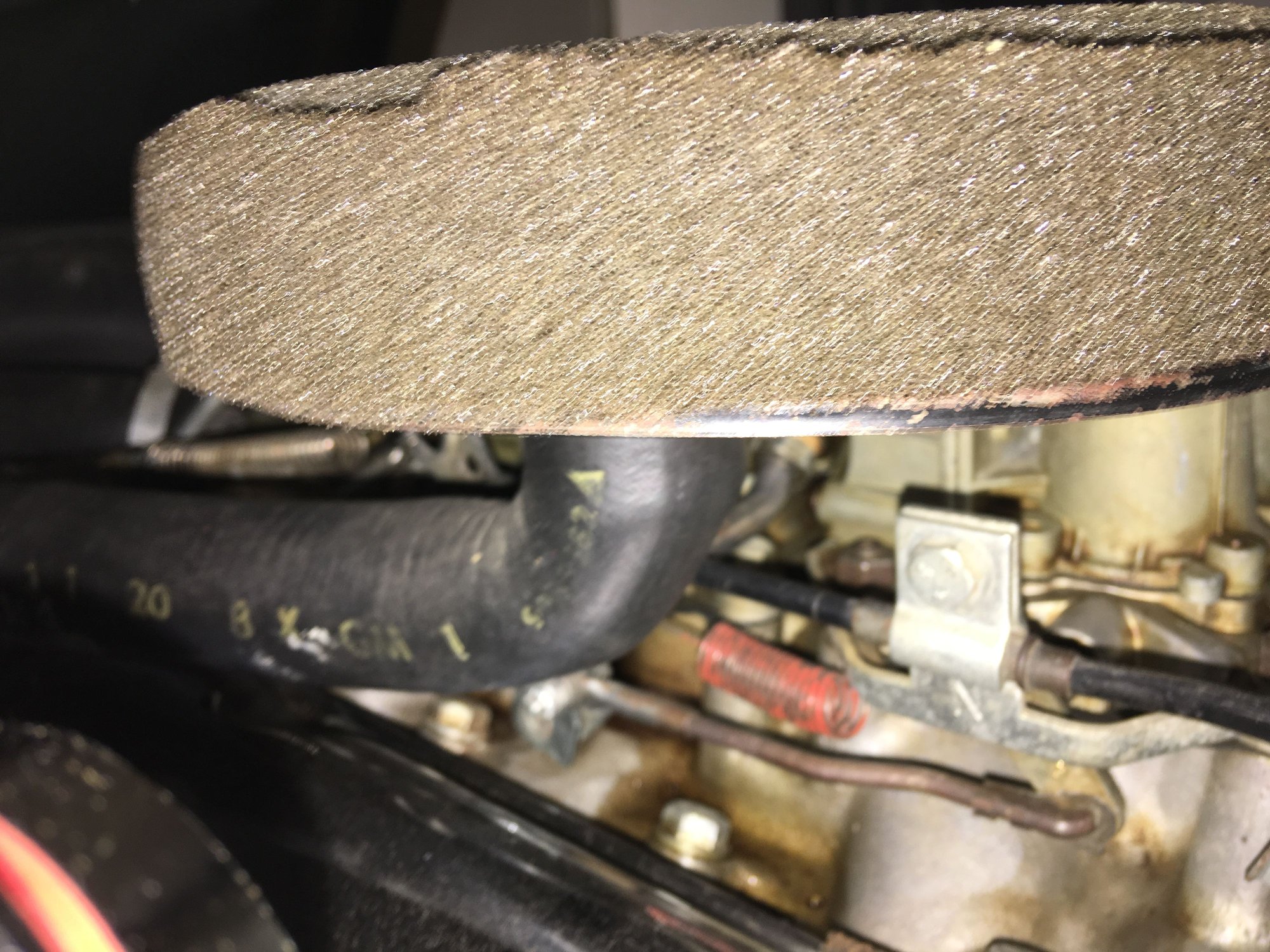

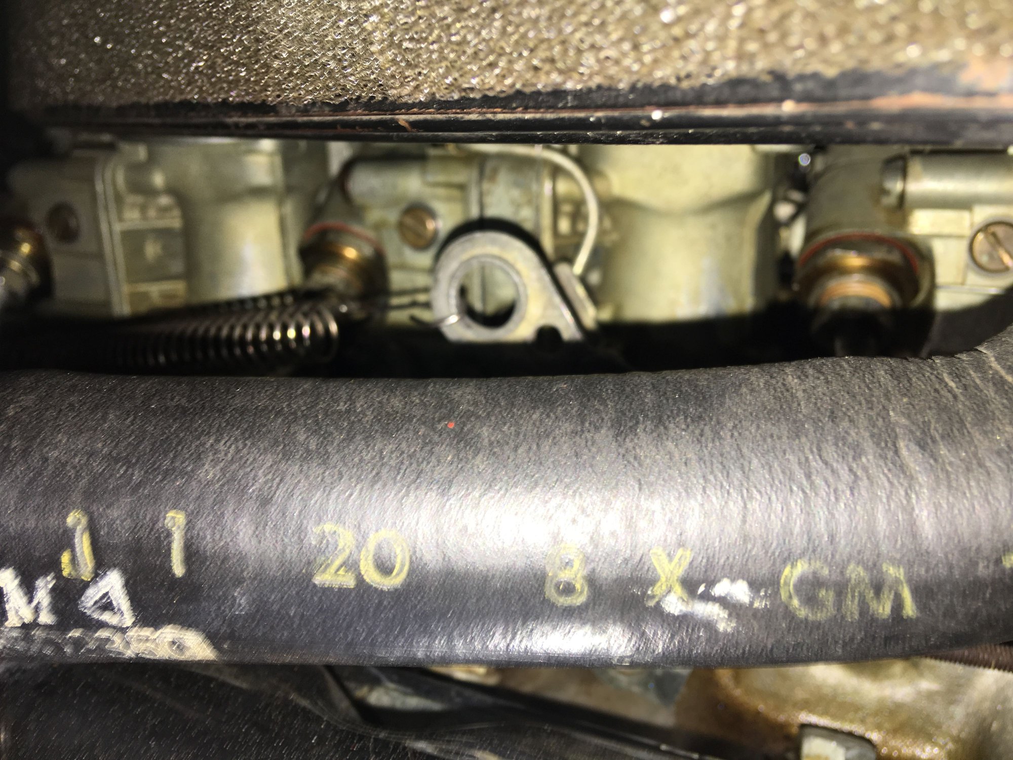

This is a pic of the linkage on my carb set up. Does this look correct?

Can't tell from your photo whether you have the adjustment tang or not (hidden behind choke linkage).
Yes, that's correct. You have the tang that simply needs to be bent with the screwdriver to alter fast idle speed.

Looking at your picture I think I'm missing some pieces. I don't see the stepped piece and the tab that tests against it. I'm assuming that is the part that keeps the throttle open for the fast idle?
I see all the parts in the photos you posted - your photos are identical to mine - just taken from a different angle. Are the photos you posted pictures of your carb? Both the cam and the tab are right there in your pictures. Your cam is black. Your tab is bolted right onto your throttle shaft. All your parts are there.

I see all the parts in the photos you posted. Are the photos you posted pictures of your carb? Both the cam and the tab are right there in your pictures. Your cam is black. Your tab is bolted right onto your throttle shaft. All your parts are there.
Yeah. I just went and looked again. It's all there. Right now the choke is open as I just ran the car and the engine has not cooled yet. I saw the slot to insert a flat blade screw driver. When twisting clockwise it will cause the cam to stop on different steps. I'm not sure the choke is setting when I push the accelerator pedal to the floor. Should the butterfly valve close when setting the choke? How do I make sure the choke is setting properly?

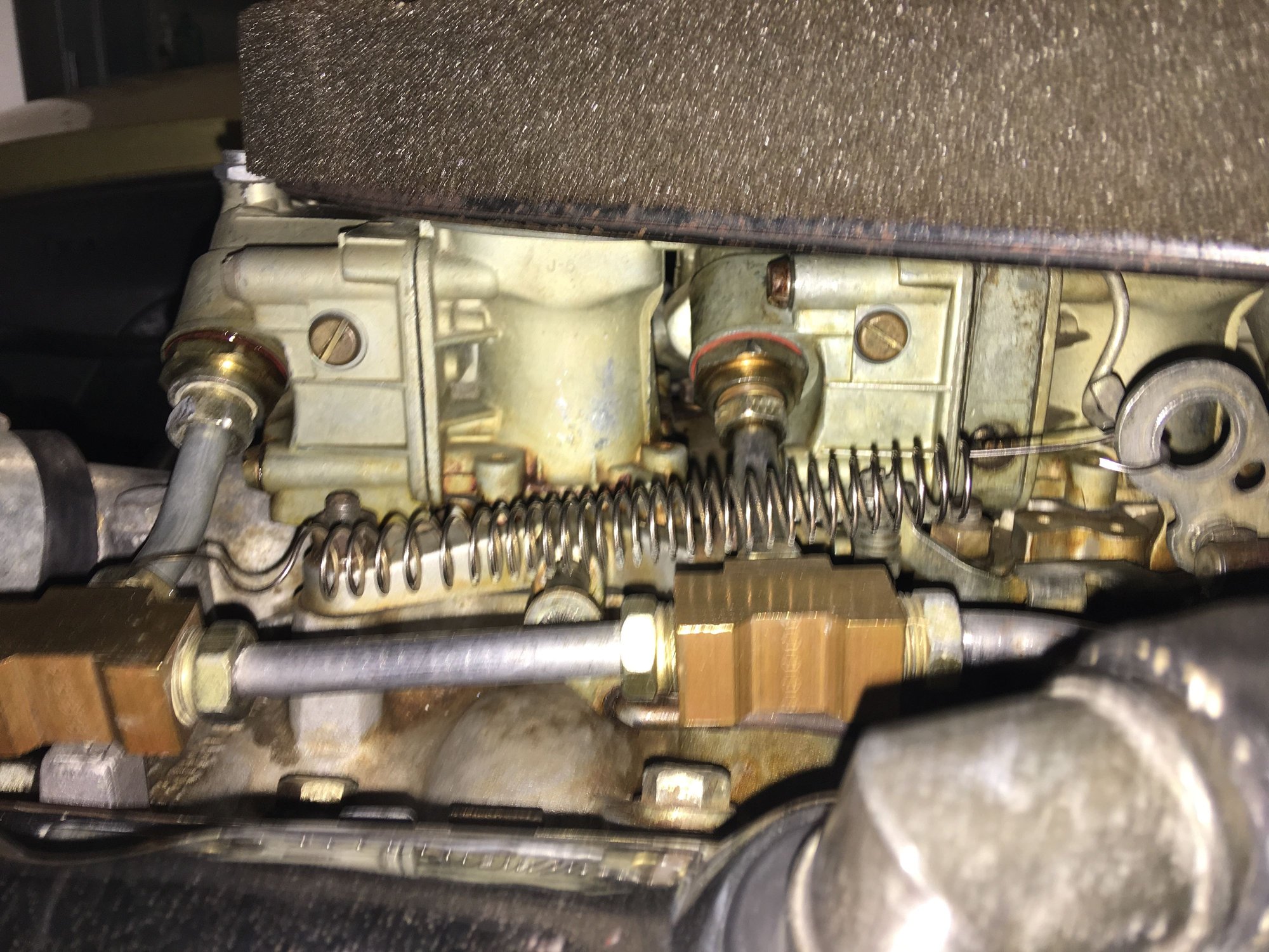

Also, Lars, here is a pic of the driver side of the carb showing the throttle. Is the long spring out of place? It is clipped to the fuel line which does not seem correct.

When the engine is dead cold, the choke should snap closed, and the plastic fast idle cam should rotate, when the throttle is cracked open. This is a simple function of the bi-metallic spring on your intake manifold pushing upwards on the rod and lever. If it pushes upwards, it will close the choke and set the fast idle cam into position.
The throttle spring position is certainly interesting... It's obvious that the center carb has had a return-to-idle problem, so someone has re-positioned the spring to pull forward at the top of the lever rather than pulling back from the bottom of the lever. This will often solve a problem with the throttle lever not returning consistently to the same idle speed. It's effective, but not correct. I would put the spring in its correct position and fix whatever is causing a return-to-idle problem.
