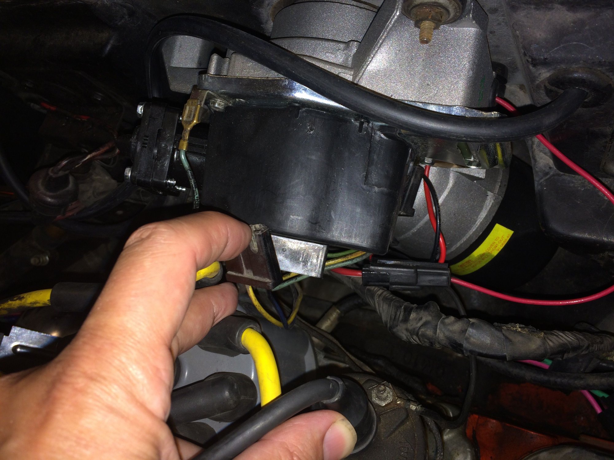

Last minute problem, When I select the wipers on, I get the washers as well. I removed the blue and yellow plug that I thought drove the washers on the back of the wiper motor but still the washers continue pumping.
I have installed a new relay under console, new wiper switch, new wiper motor and new washer pump. Wipers park, operate in slow and fast speed as they should. They just will not stop washing, even when I remove the blue and yellow plug.

That wire is for window washer . It looks like you just have a cover plate on your wiper motor .

Hi V71,
Disconnecting the blue/yellow connectors SHOULD stop the washer pump.
If it doesn't that indicates someone has played with the wiring for the motor/pump.
From the photo it appears the wiper motor/washer pump is a combination of new and old parts.
Is it something you've put together or was it done by someone who worked on your car prior to you?
Regards,
Alan
I believe this is a typical configuration for a 69 motor/pump. Note the washer connectors are separate and slip into individual barrel connectors on the pump. Has your harness been changed? (part of the thin plastic cover has been cut off that's why the connections are exposed.)

Hi V71,
Yes, I agree that the pump wires are blue and yellow.
I think the motor/pump in the picture may have been in a car that had it's engine compartment 'detailed' with some black paint… thus their appearance. I posted it mainly to show the general configuration.
This is a later motor/pump but shows what I believe is the typical blue/yellow wire configuration and black plastic cover.

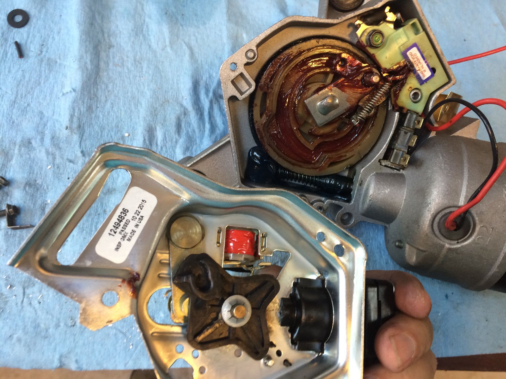

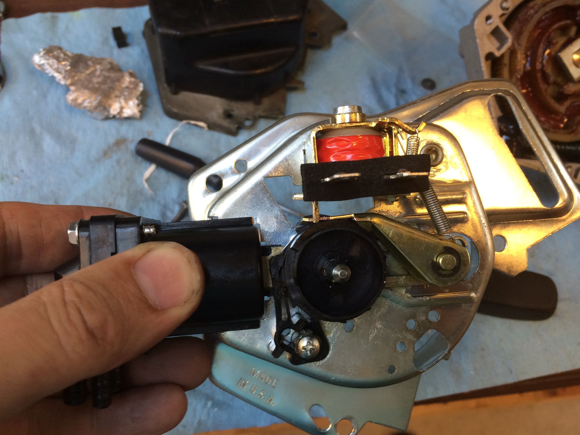

That is strange Alan, I can chase mine right under the dash and it looks factory but who knows after 50 years.
I removed the motor and the cover. The wiring is sending the right signal at the right time so I have isolated it to the motor/pump. I ran it with the cover off and it just keeps pumping when wiper motor runs. I can't quite understand how this thing is meant to work and how the solenoid when energized it supposed to activate the pump mechanism.
Maybe these two items are just not compatible but I hesitate to buy more parts as I just don't quite understand how it is intended to work. Any ideas would be appreciated.
Pete

Hi Pete,
I'm really poor with things electrical! So I can't be of much, if any, help.
I do see that the blue/yellow connection on the pump isn't what I'd expect to see on a 69 motor/pump.
Are you saying the blue/yellow wires in your picture actually run through the firewall to the interior?
If so that's not typical. The blue/yellow wires in the compartment are part of the engine harness and run to the harness connections at the fuse box where the meet their counterpart on the other side of the firewall that are part of the dash harness.
Regards,
Alan
