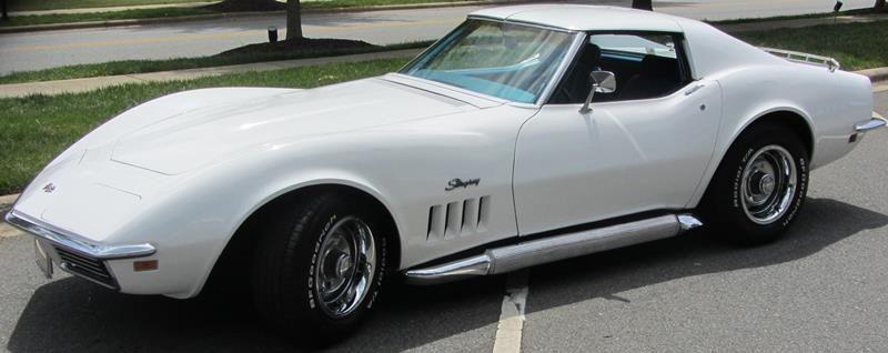

I installed a set of the Allen chambered sided exhaust pipes attached to a set of Hedman shorty headers with a ball & socket connection on my '69 base 350 coupe. These were the Allen aluminum pipes that went for $495. I actually got the pipes off a Craigslist seller so I didn't get any documentation with them (they were new). I have a set of original GM over-the-counter 69 side pipe covers installed with these pipes and they fit pretty well together. Here's a link to the Allen Exhaust home page: http://allencorvetteexhaustsystems.com/ . Allen has big block pipes listed. The chambered pipes give my '69 a mid-year sound without the loudness of the '69 pipes. You can hear the radio or have a conversation while driving the Corvette but people can still "hear you coming or starting up". Here's a couple of pics of the pipes before/after the covers were added.
