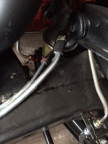

There wasnt much left to the fuel system on my 73 when I got it. Piecing it back together, the only fuel filter is the small inlet filter in the carb. (qjet). Other than the pick-up screen in the tank, was there anything else? I've seen some canister type filters spliced in the fuel line up by the engine on some of the older big blocks. Was wonder if I should put one in, if so, what's a good one to use. I have this older frame rail filter from a mid 90's suburban. The size is about right but I dont think the fittings will work. Suggestions?

Thanks 71, I'll check Summit's web site for that. That looks like a clean install too from the picture above. Alan, no situation as I haven't fired the engine yet. But looking at a lot of under hood pictures, I see a lot of them installed, even factory AC filters. Just wondering if it was needed or not. Considering that there wasn't any thing else originally on the car, maybe I'll rethink this a while.....

There is no good reason to install an in-line filter if you have a street car with the in-carb Q-Jet filter. If you want an in-line filter for the looks, be sure to remove the in-carb filter - running 2 filters will cause fuel flow problems, so just run one or the other. Especially bad is running a fliter on the suction side of a mechanical diaphragm pump, such as back by the tank. That will induce vapor lock issues and fuel starvation at high rpm - only use a filter on the pressure side of the pump.
The in-carb filter actually flows pretty good, and the paper element is the same element that a lot of the aftermarket in-line filters use inside their aluminum housings - you would be replacing the in-carb filter for exactly the same filter in an in-line housing, with a bunch of work to make it work. Not sure there's much of a point to that...
