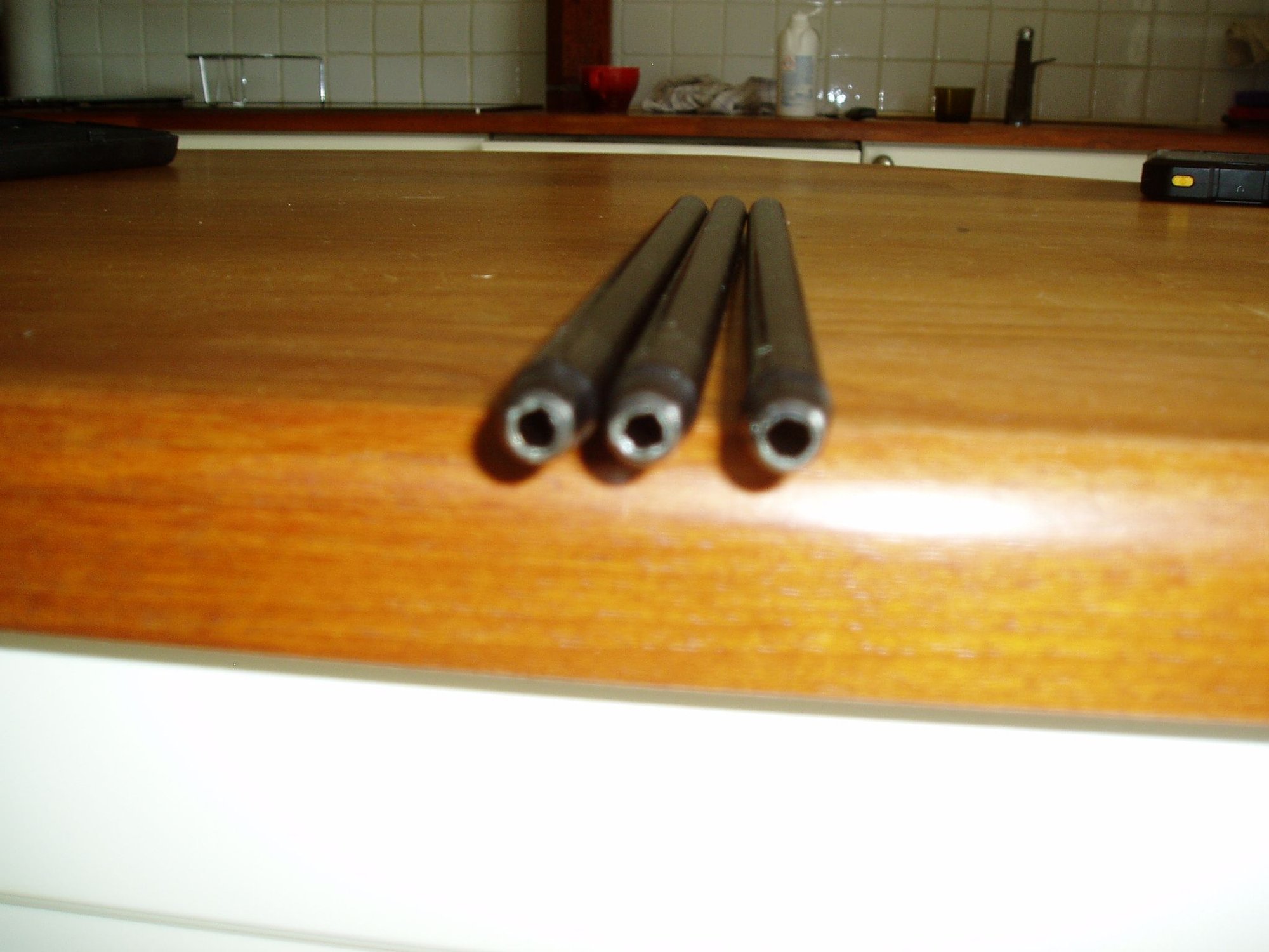

I have written with Maxwell at Comp Cams, He select suggest going with the Hi Tech 3/8 .135 wall pushrods
But I do not like the ball end. because it is made in one piece, I drove with Comp cams Hi-Tech 8680 3/8 .080 wall thickness,
three pushrod smashed the ball end.
should not happen Again with my new cam.
[/COLOR][/U][/COLOR][/COLOR]

Happened to me too, will never buy push-rods with the ball on the ends. Was checking the lash on my 406ci solid roler and it was changing all the time. Took a pushrod out and the ball on the end was wearing down, I threw them in the garbage
