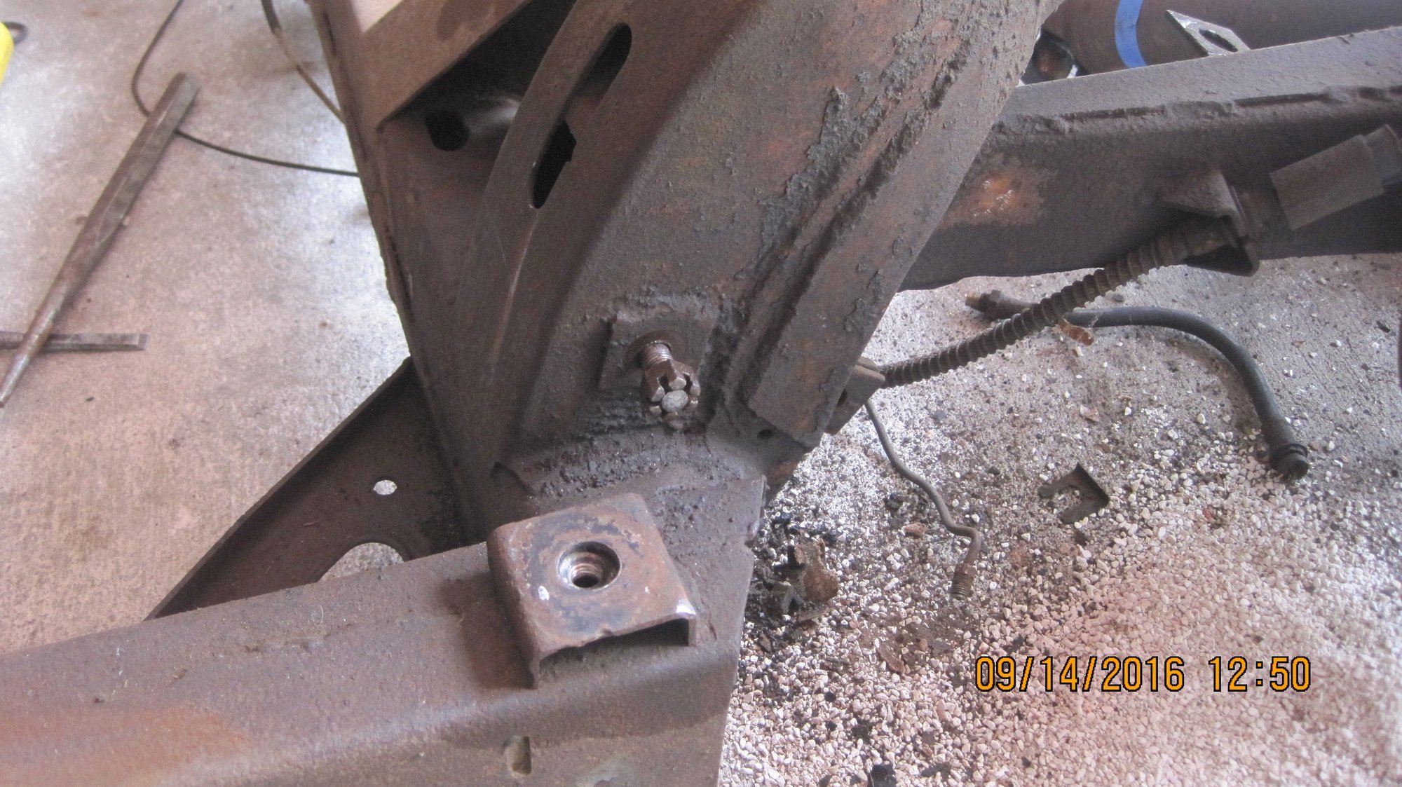

Does any one know how to get this bolt out? It will spin from the bolt head side and the nut can come off, but i have hit it with a hammer with lotsa of spray break free stuff and the spacers move and i have put the trailing arm in a position to take the load off. Still when i wack on the nut it will not slide out.

when I changed my trailing arms ,I had to use a sawsall with a long blade .cut the bolt but keep track of the shims .its a good start when you align the rear end.

Probably a big buildup of rust on the inside. You are replacing all those parts anyway, so get a BFH and pound it out.

Since you have the bolt turning the sleeve that's inside the t-arm bushing must be frozen to the bolt.
Have you tried to get the rust buster in on the bolt as it phases through the t-arm.
Do you have ANY space on each side of the t-arm?… people talk about having to use a sawz-all to cut the bolt.
Regards,
Alan
I'd be careful about 'pounding' on it for fear that the t-arm and shims may bulge out the side of the t-arm pocket opposite of where you pound.

It's a tight spot and i apparently cant get lube in between the bolt and spacer.

As Alan says, careful you don't bend the frame pounding on the bolt or flare it even worse.
Bolt is toast anyway so sawsall, especially since you can actually get at it there (spoiled)

pull out the shims then push the bolt to one side and cut off the long side with a Sawzall, push the bolt the other way and make another cut, the t-arm will then come out of the pocket, you will most likely need to replace the bushings anyway

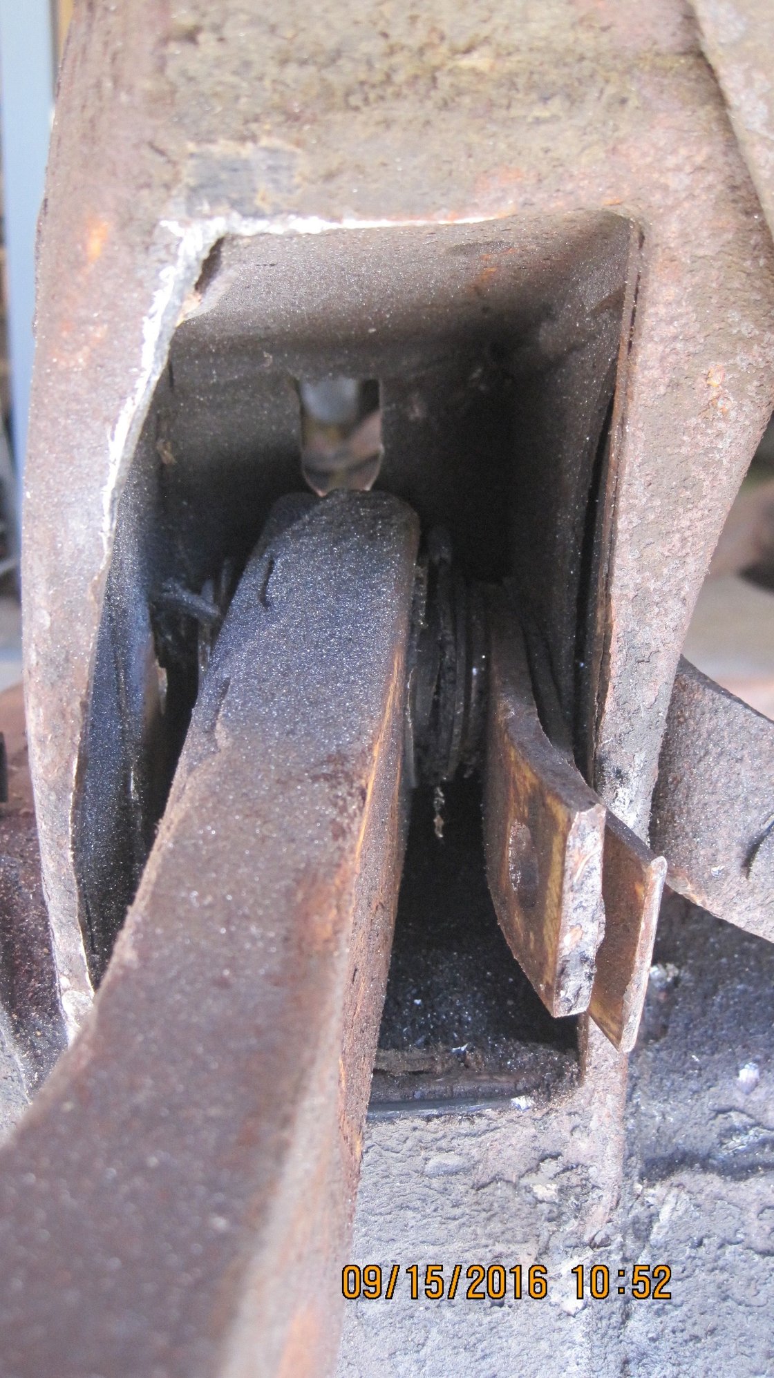

That is exactly what I did. I was able to pry the shims out some with big screw driver then I was able to get a claw hammer on the shims and pulled them out like a wisdom tooth. One the shims were out I used a sawzall to cut through the bolt on each side of the trailing arm. With the body off he will have easy access.

Because you have access to the bolt head and nut, use the saws-all on the outside of the pocket. Remove the shims, drive the bolt to one side and cut the opposite side flush, then reverse sides. There should be enough movement in the bolt to compensate for the thickness of the frame.

Well the shims are not going to be removed! The bolt goes though the shims, so had to cut the shims and the bolt together, what a pain.
To top it off, once the one cut on the bolt was done, the trailing arm wouldn't slide over to give me room to cut the other side , so i had to cut the shims and bolt together,again.

Yup, the early shims were drilled. The later ones were slotted (see my pic above)
Depending on your level of restore you may want to consider the slotted shims when you re-assemble your arms. Stainless shims are also available

Just remember that if you use slotted shim you MUST put in the cotter pin to keep them from coming out. If you look at your top picture in the middle on the right side of that bolt you will see a small hole. That is where it goes. If you don't, you will lose them and have issue. I learned the hard way. The shims you have didn't need them as they were not slotted.
