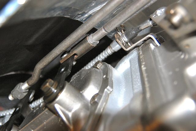

Hi b69,
Here's where the 'clip' goes and the lever which both '75 and DUB mention must be in the full 'up' position.
Moving shifter to reverse moves the lever UP.
Good Luck!
Regards,
Alan
Right side of steering column.

Thank you very much, I got the key out. Is there any adjustment in this mechanism or do i simply need to lubricate the cable as it continues to do the same thing over again.
Thanks.

Hi bill,
The cable is a fixed length with no adjustment at either end.
You're correct in thinking the cable should be free to move in it's sheath so that the lever on the steering column is moved as far up as possible when the reverse lever on the transmission is moved.
Regards,
Alan
No adjustment possible.
