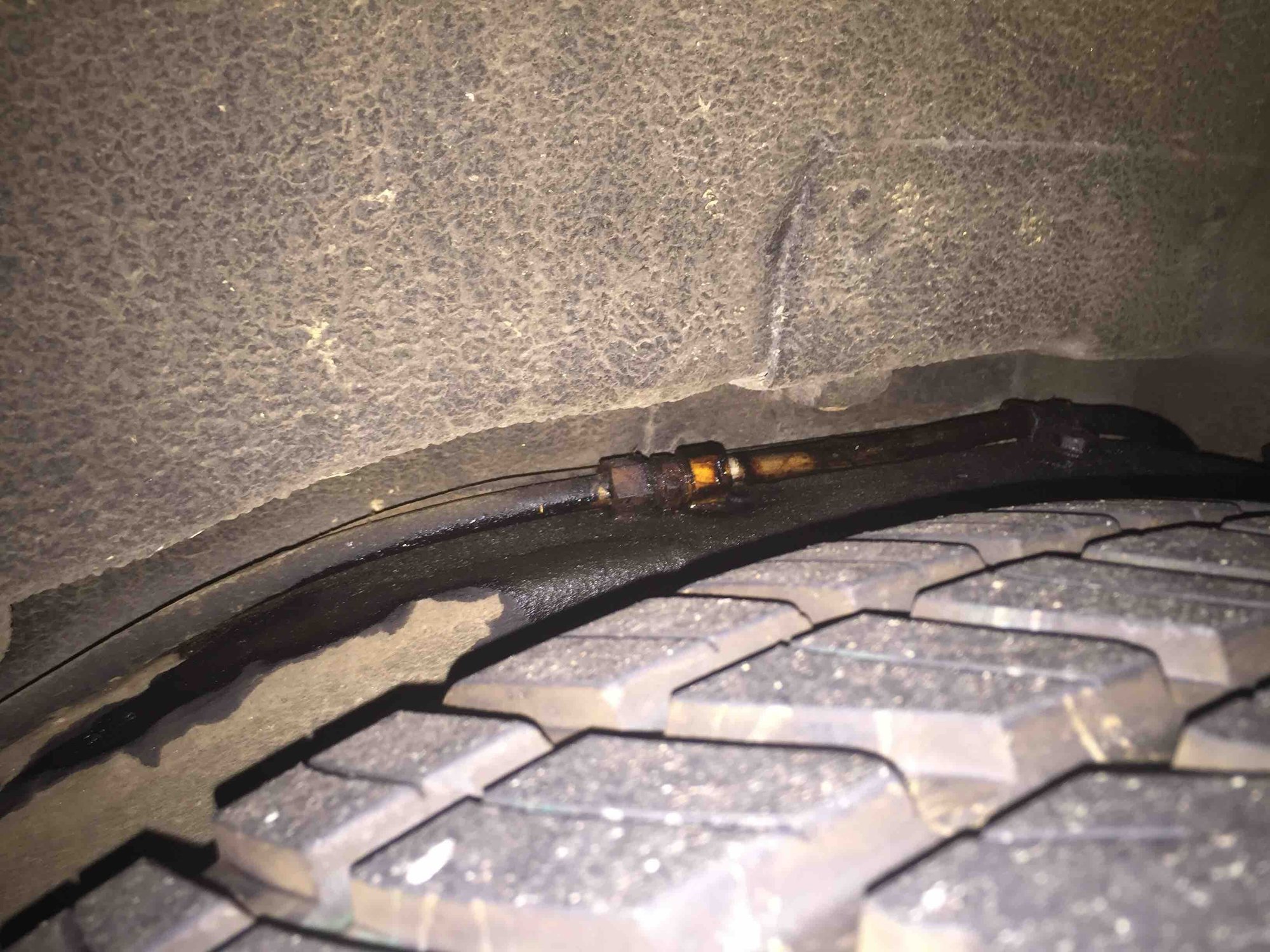

smells like fuel--there is a Union on the frame rail that is leaking:

Thanks for the help, guys...I'll have to re-flare and replace the union...
Any thoughts on how to pull this off without dumping the fuel tank?
Old Dec 26, 2016 | 04:00 PM
'75's Avatar
'75
Joined: Dec 2007
Posts: 6,422
Likes: 591
From: McHenry Illinois
You should be able to get wrenches on the fitting and tighten it up, may not have been tightened enough originally. That looks like a compression union, no flare.

If you're car's tank has the sending unit in the bottom of the tank and you end up needing to replace part of the hard line you can crimp the rubber hose that runs from the sender to the hard line.
This will allow you to do the repair without draining the tank.
There were no unions used on the fuel line originally so what you're seeing is part of a previous repair.
Regards,
Alan
This photo is of a 71 so it has a 'return' line too. Depending on the year of your car it may be hidden in your photo, have not had a return line, or it's been removed.

Glad you found the problem and THAT explains why it is wet further up on your frame as I had mentioned.
Originally Posted by keithl1967
I OFTEN times get my a$$ handed to me when I comment on fuel lines being cut and joined together. "They" seem to always seem to think that just because the fuel supply line is NOT under pressure....there is NO major concern. WELL...this photo shows that it IS a concern. AND...this photo is a CLEAR reason why.
I only install the fuel lines as they were designed...and I DO NOT cut them and join them in any manner.
People can choose to do what they wish....But I can tell you that one day...a long time ago..I came into my shop and when I walked in... it smelled really bad of gas fumes. One of the Corvettes overnight began to LEAK A LOT of fuel at a BOZO repair in the fuel line that someone did.
SO when I see repairs like this....that were NOT ever 'supposed' to fail...and did....I just roll my eyes and shake my head.

It's a 1977...I'll have to get a fuel line on order...wish it could wait to spring--garage floor is frigid here in PA this time of year!! Don't want to leave it like that though, for the next three+ months!
maybe tighten her up or replace the union for now, then proper repair later...
