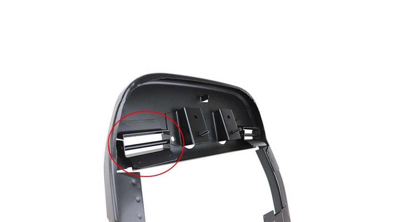

I have a '73 convertible. I'd like to add shoulder belts, but keep the car as factory looking as possible. I have the seat belt warning system working, so I think I need to go with the factory style shoulder belts vs the f-body rear seat belt option. To have the shoulder belts go through the seat backs, I think I need to modify the seat back frames or purchase different ones. As anyone modified the frames? I think there is a bracket that welds to the front face of the frame. I don't know if this is available from the vendors. I can find the internal bracket that supports the bezel on the back of the seat.

Hopefully Paul74 will see this thread and reply, he did this to his several years ago and can fill in all the blanks for you.

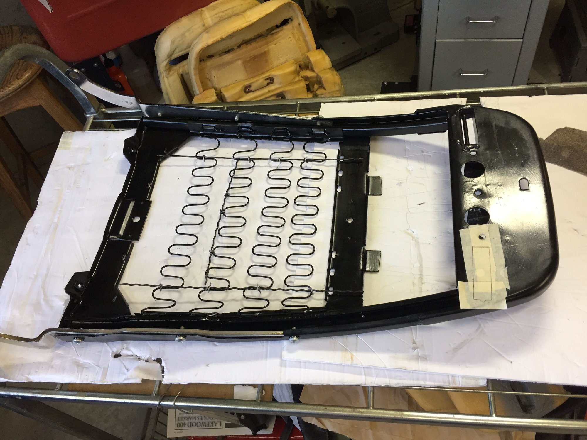

Thanks 75, Paul74 did respond to a PM I sent. He shared a nice photo of the parts I need. I did find a photo I took of my bare seat backs and I was doing my restoration earlier this year, and for '73 the seat backs did come with the slots and associated brackets already in the frame which is a big relief.

Thanks for the tips. After receiving a PM response from Paul74 indicating my seat backs likely had the cutout, I found a photo I took when I was restoring my seat backs that confirmed at least for a '73, the seat backs did come with the cutouts.

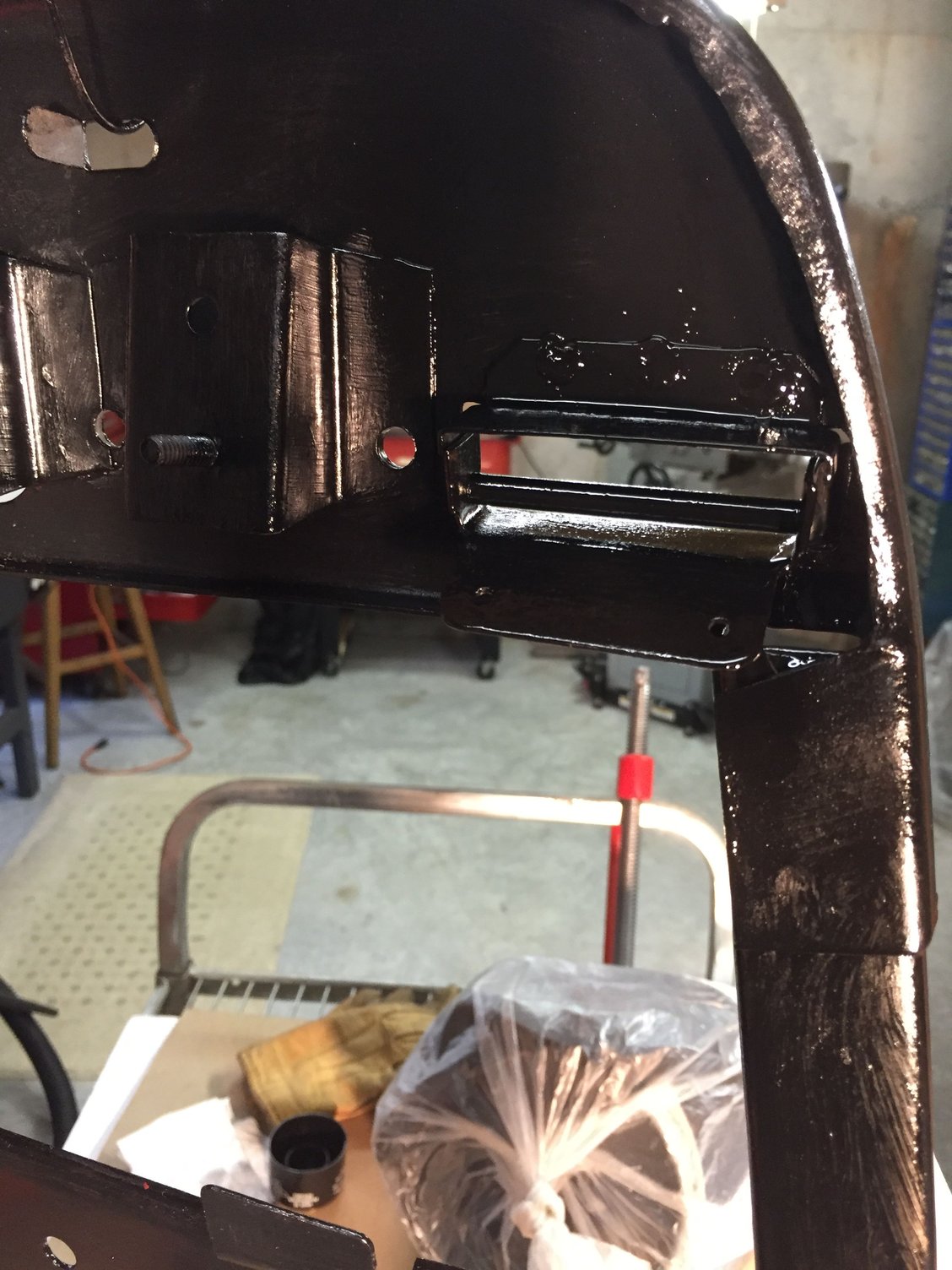

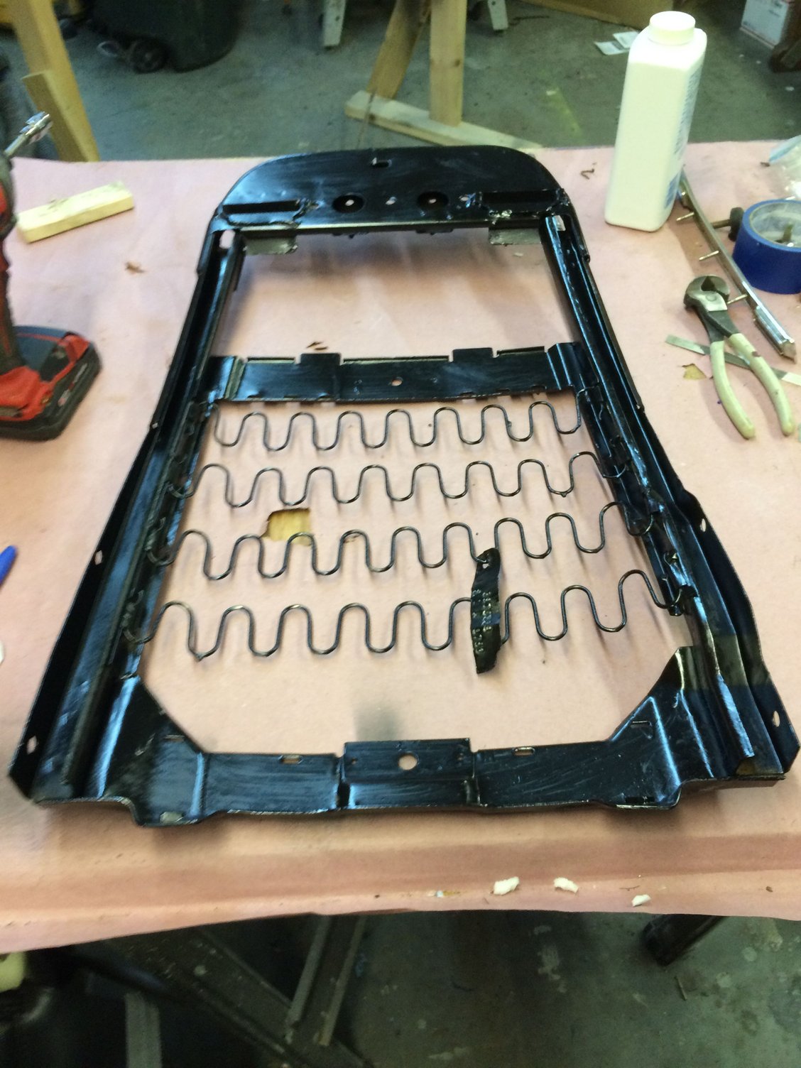

Hi jk,
Here are a couple of photos of the front and rear sides of the seat back and the cuts for the belt.
Maybe they'll be useful to you.
Regards,
Alan
Note, the vinyl is slit on 3 sides but stays attached at the bottom edge.

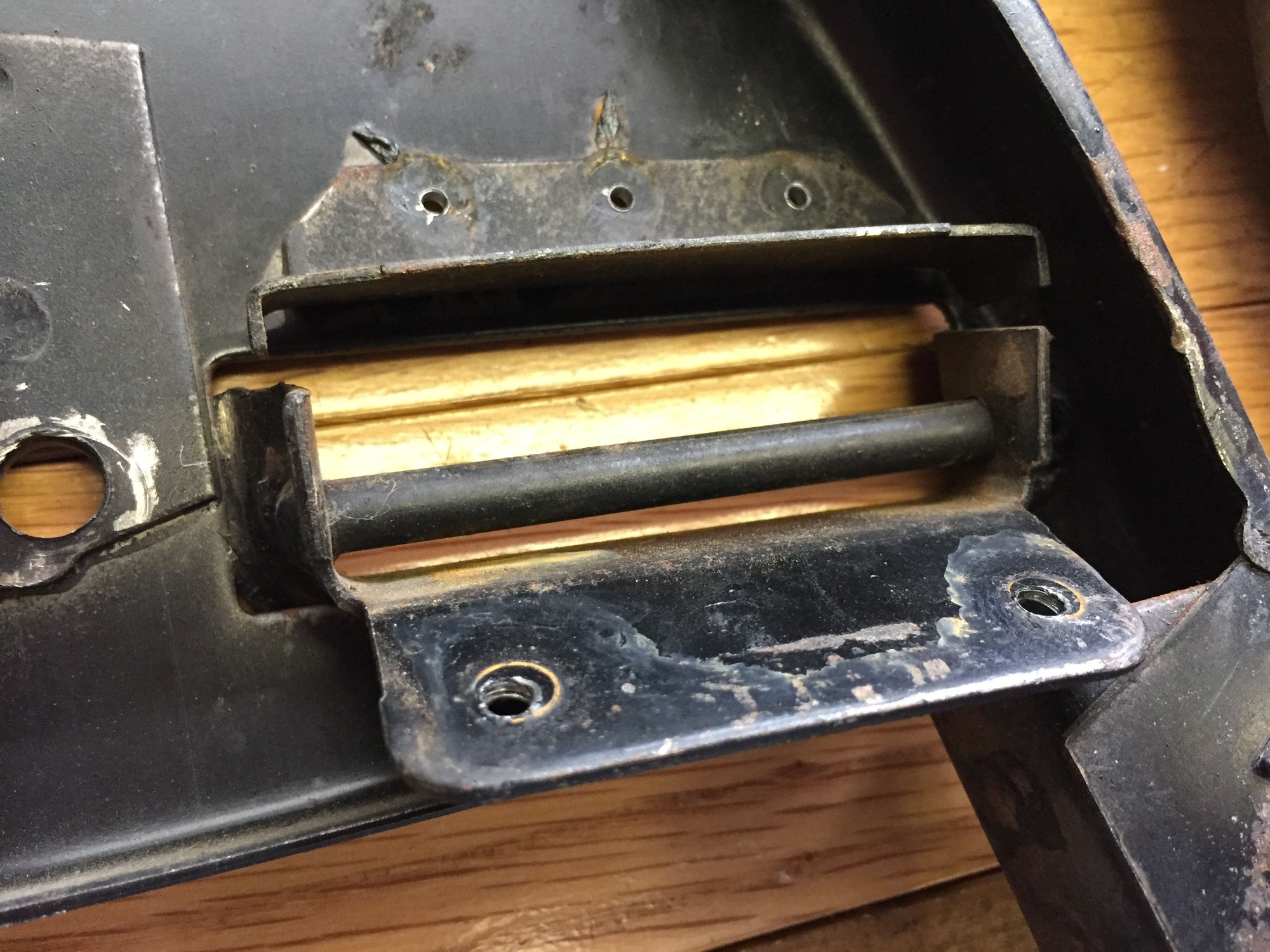

All hardware bolted together. A pre-Alan shot.

In looking at the AIM it appears all seat back frames had the provision for the shoulder belt.
It appears as though the proper front trim bezel and smaller rear trim bezel were applied on coupes and convertibles with the shoulder belt option.
The AIM indicates that the 'insert' (the metal part in the seat frame) is to be used as a 'guide' for cutting the vinyl on the back of the seat.
There doesn't seem to be any guidance for cutting the vinyl for the front bezel.
