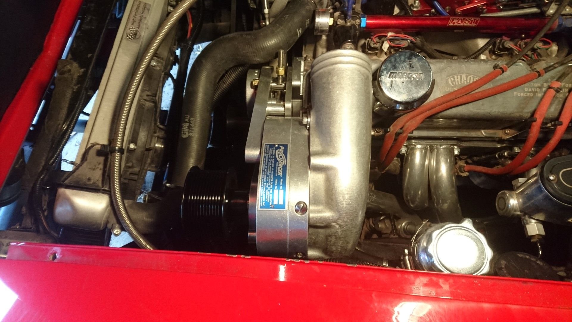

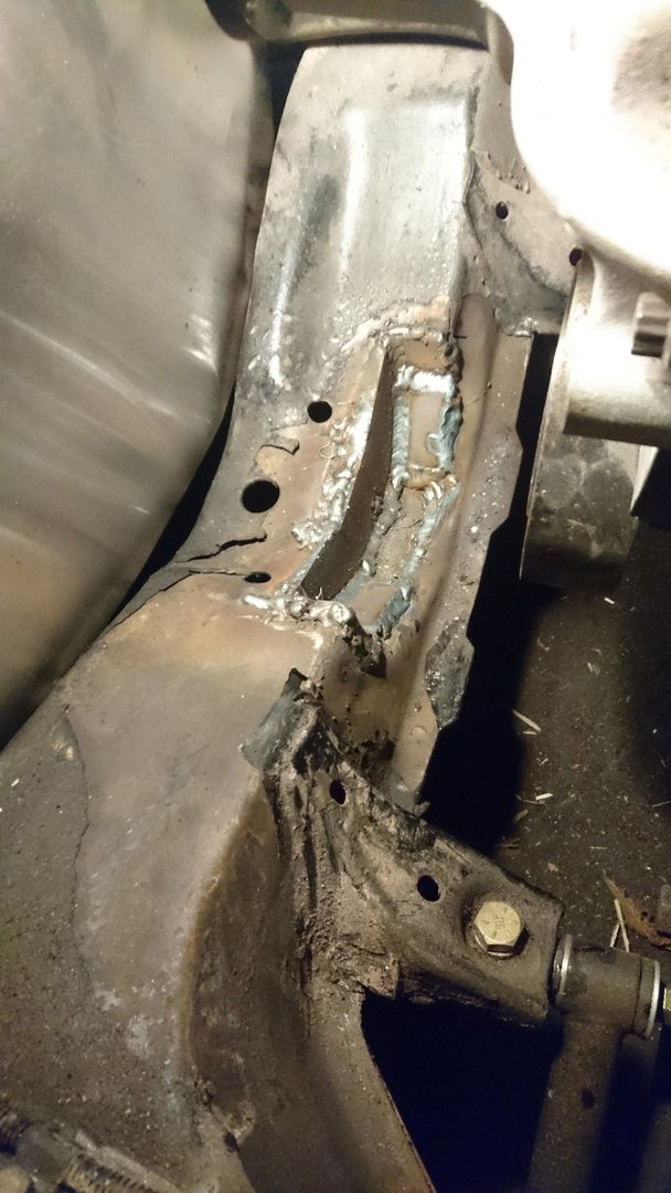

pic of alt position to suit pro C
cut cross member, plated up with 4 mm steel

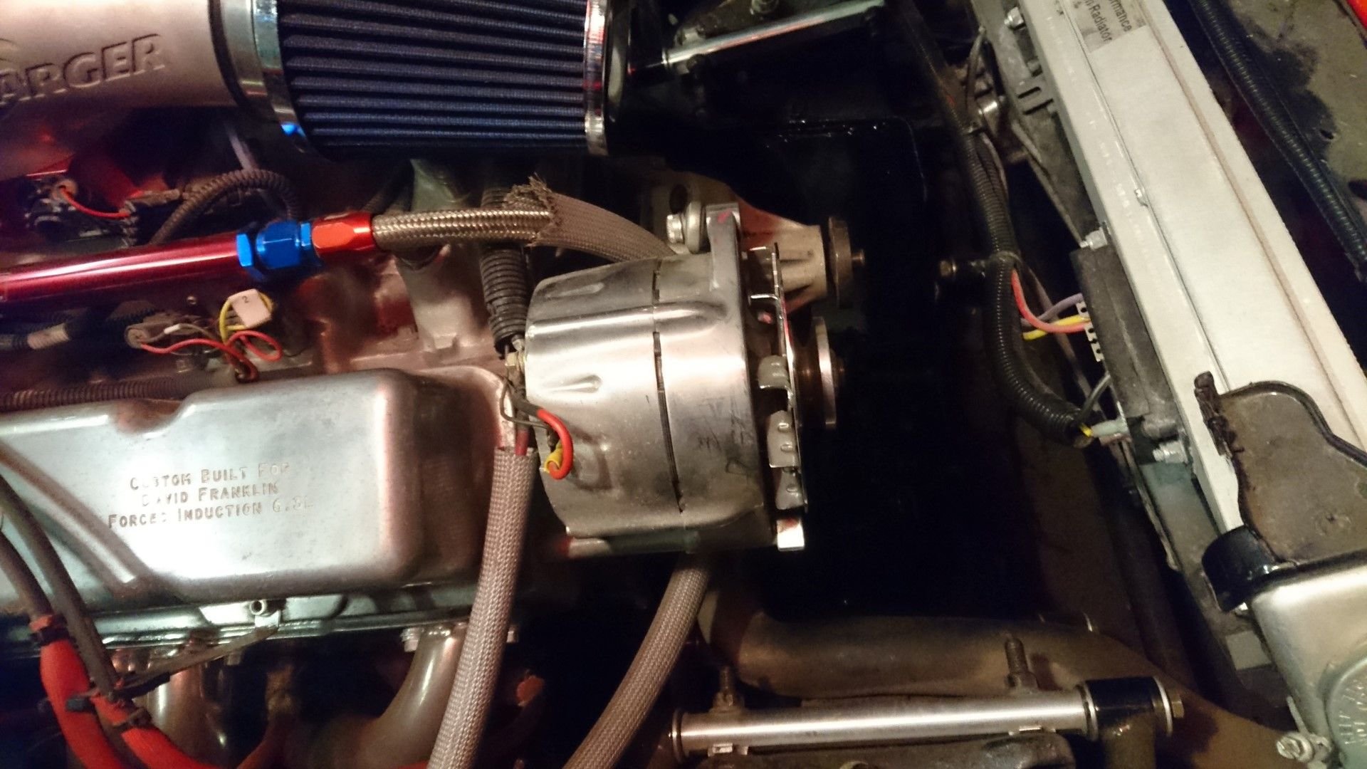

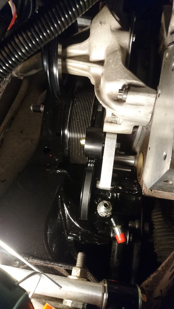

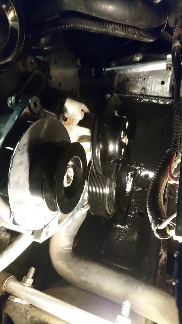

some more info on pulleys, by using the supplied procharger pulleys, everything lines up perfect
gm type 2, again using procharger bracket and pulley, just need to plump it all up, using a cooler on steering system aswell

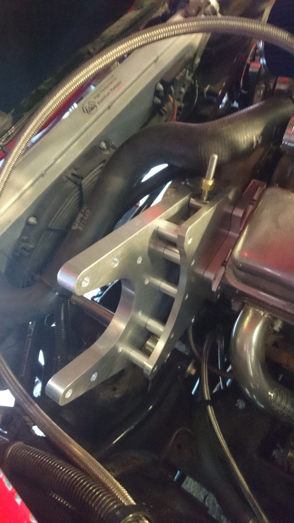

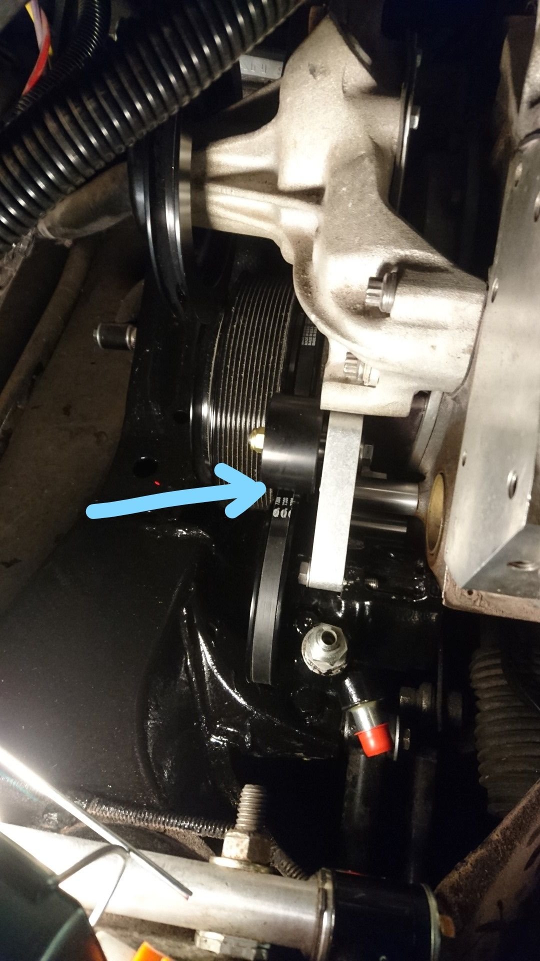

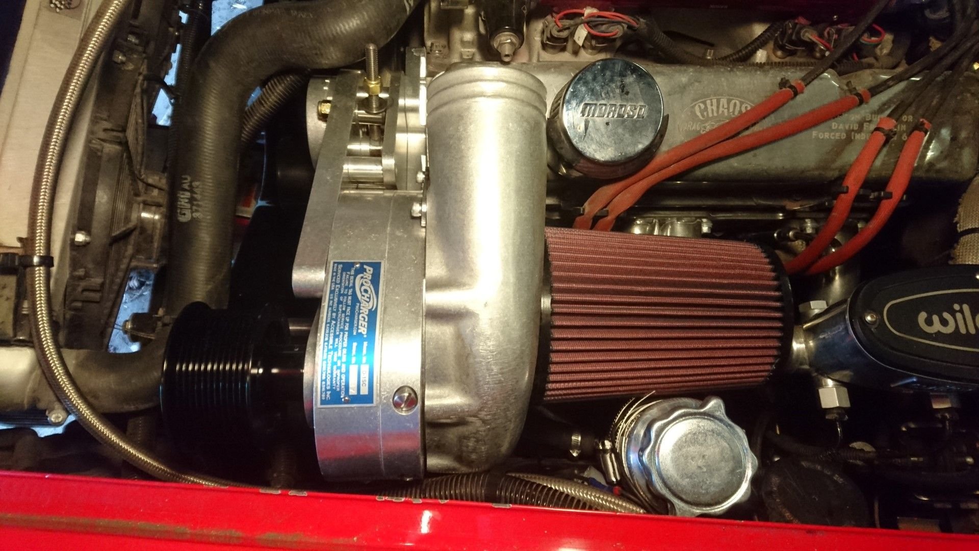

Update - steering system all plumbed in and working, one small ****le with the pro charger kit, the placement of the tensioner pully on the power steering bracket from procharger is too close to the power steering pulley, so hard to get enough tension on the belt, cos it ends up hitting the power stering pulley, maybe a shorter belt might help, the power steering is working, but belts feel alittle slack

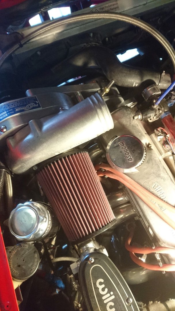

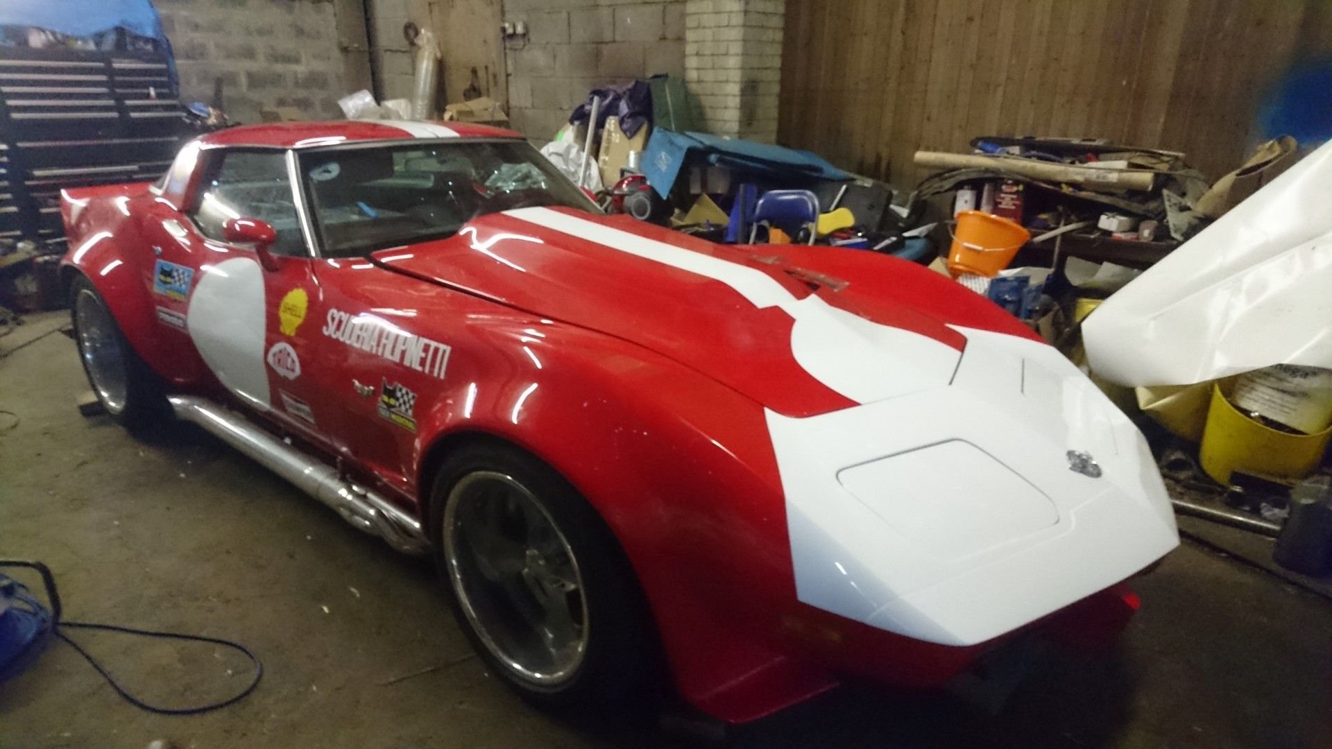

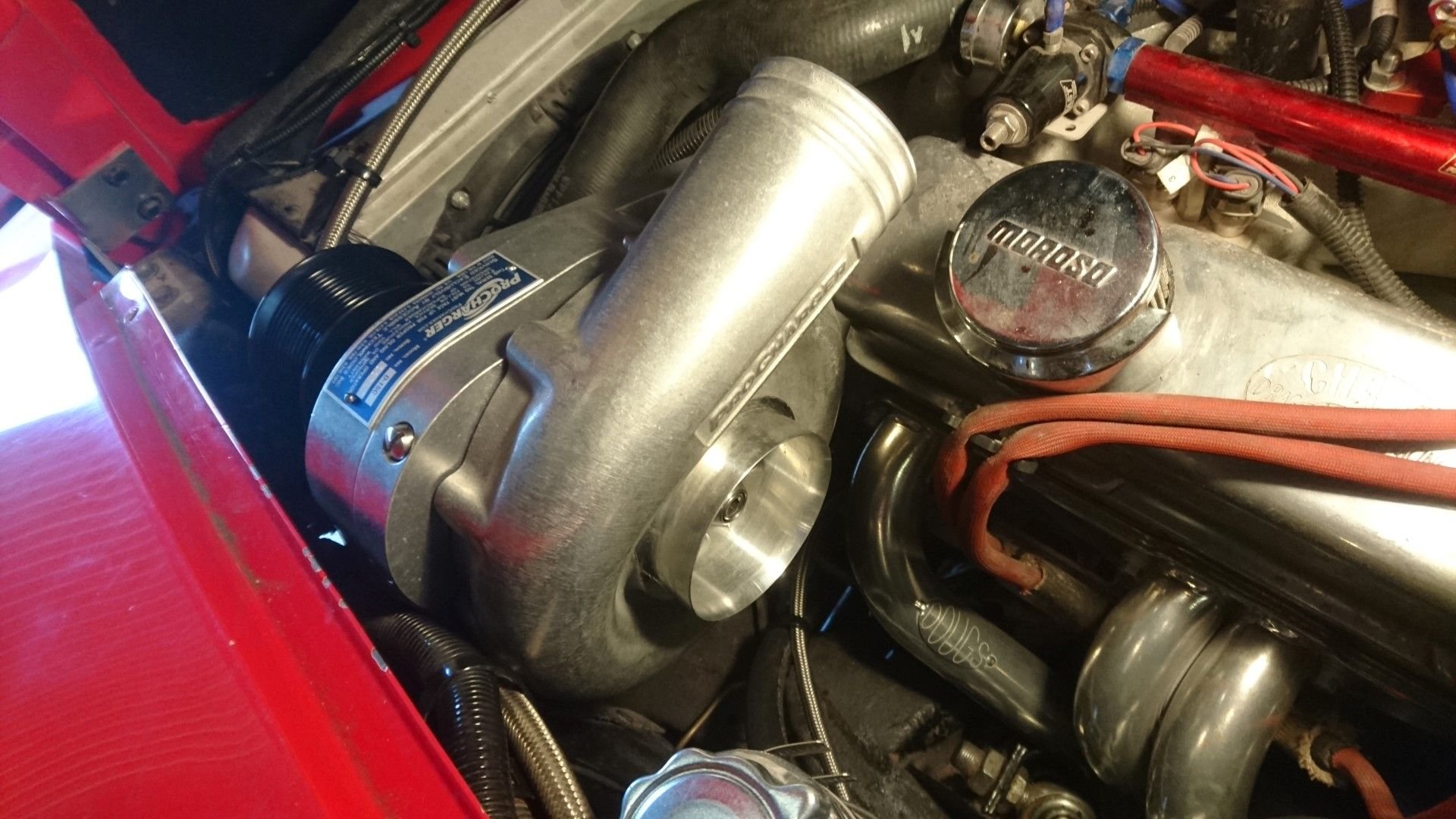

Update - fitted procharger bracket and then procharger itself, all fits nicely, apart from bonnet issue

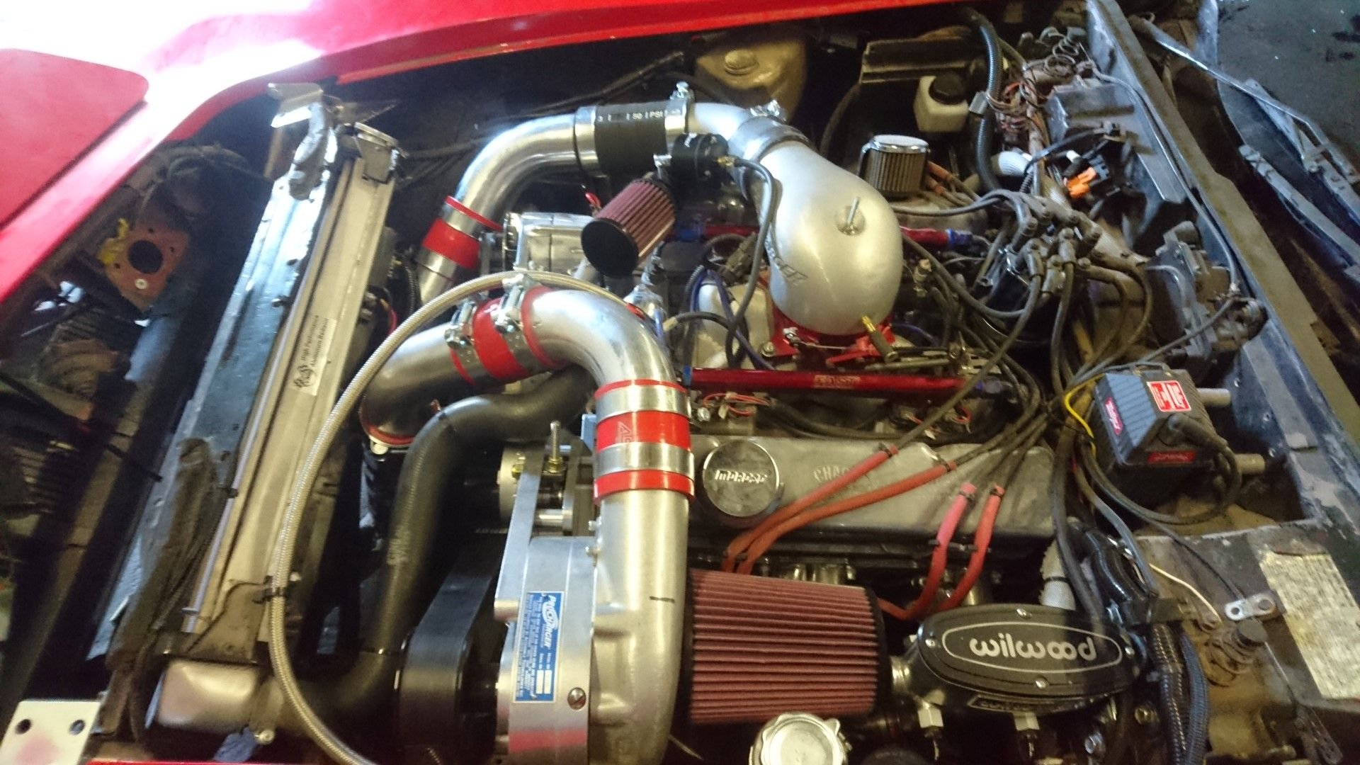

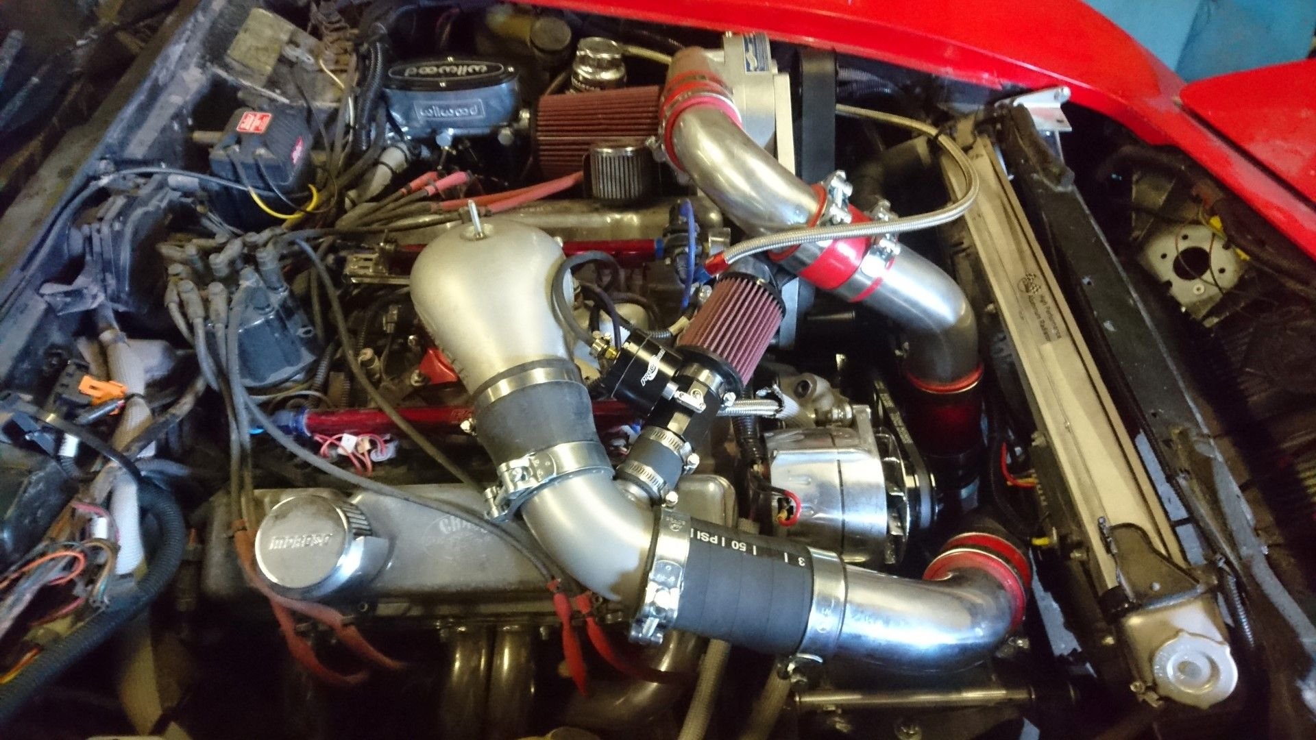

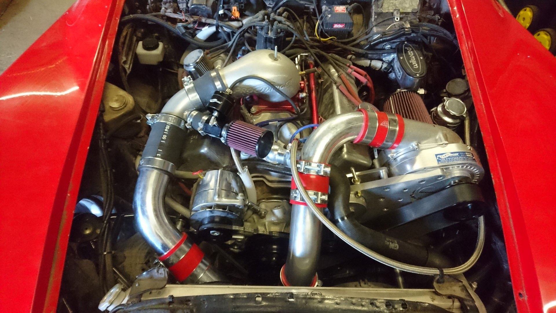

updates - thats it all fitted up and intercooler fitted aswell, time for alot of fuel mapping!

short video of vette up and running procharger, getting 15.7 psi of boost at 6400 rpm, intercooled, running super unleaded, no issues atall at top end, not running lean etc

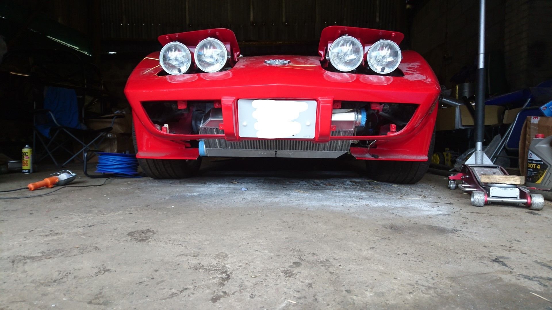

May I ask a few questions?
is it a off the shelf inter cooler? If so which one?
can you please share some pix of the final way you mounted it and plumbing.
I need one for my F1 PC and am in the process of trying to figure out how to do it
thanks
Old Jul 2, 2017 | 01:29 PM
corvettedave383's Avatar
corvettedave383
Joined: Apr 2008
Posts: 825
Likes: 40
From: Glasgow, Scotland
thanks
the intercooler is from procharger came with the sbc universal kit, has 3 inch inlets and therefore ive used 3 inch alloy piping, i mounted it to the front tube thing that holds vacuum for lights, welded on 2 L brackets and drilled hole in them and bolted intercooler to them with long bolts, the intercooler will sit tight up againest inner front crash thing and sit againest bottom of rad bottom support frame
i used 135 degree silicone tubes on the intercooler inlets, the top one is tight againest the side light/indicator bulb holder, i drilled new hole for sidelight bulb connector, siting slightly higher in the plastic unit
then the piping goes towards the middle of car, then 90 degree upwards between front sway bar and water pump area, then you can can see from pics
i made a alloy sheet front scoop to help ram air into the intercooler, without that, dont think it would work aswell, due to the 45 degree angle of intercooler, part of the front scoop has to be removed to get it all in there
anymore help needed, let me know
