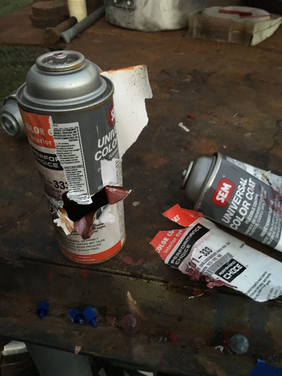

Totally agree with everything said here. However, unless you are using something that I can't find on the SEM website, the stuff is not a dye. And yes you can use it on carpet. The website has a great FAQ and Instructional page. Check it out.
SEM Color Coat Aerosols
Click to Enlarge
Color Coat™ is a specialty elastomeric coating formulated to restore or change the color of most vinyl surfaces, flexible and rigid plastics, carpet and velour. Color Coat is not a dye, but a fade resistant flexible and permanent coating.
The aerosol or mixed quart or gallon containers contain the same makeup as far as I can see.
Tech Data Sheet
