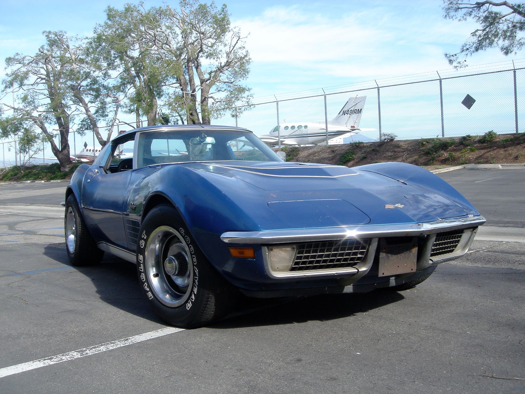

Default 1971 LT-1, What to do while...
...the radiator, core support, alternator, water pump, harmonic balancer pulleys, heater hoses and radiator hoses are out of the car?!?
Car is 1971 LT-1, M-21, Bridgehampton blue coupe, no tank sticker (we replaced the tank with an OAL replacement already), new stainless brake calipers, no power anything, rebuilt heads installed in the 90's, lots of miles but pretty much original but needs a lot of TLC. Car has original TI ignition, original chrome ignition shroud stuff over the plugs & etc., lots of documentation (sales receipt, and repair receipts for 20 or so years, original Owners Manual, only one key and its really worn, no spare wheel!, but has the cover, but no key to the cover lock, original t-top strap and some covers maybe its for the rear window, no jack nor handle, carpet in the back is perfect, but old, seats are shot, rubber seals are shot, window felts are shot, could use a drivers side door panel, original glass, E brake console cracked on top, will post pic later
Right now I have the radiator and support out, shop said it's not repairable. So maybe I'll get a date coded correct replacement??? Radiator core support is on order, likely reuse the original foam seals, thoughts? Having all the black metal pieces cleaned and powder coated - is that ok to have the pulleys done that way? Got a date coded original WP from Bill Mock. Ordered a new date coded fuel pump, and hard lines to carb, new tarpaper A-arm covers, will likely NOT reinstall the air pump which was pretty much doing nothing, may consider having it rebuilt and reuse later. Carb is at Chris's Carb Shop being rebuilt. Will replace thermostat - what temp should I use, 180, 160,???
What else should I tackle while the front is pretty much cleaned out? :toe tap: Thanks in advance!
